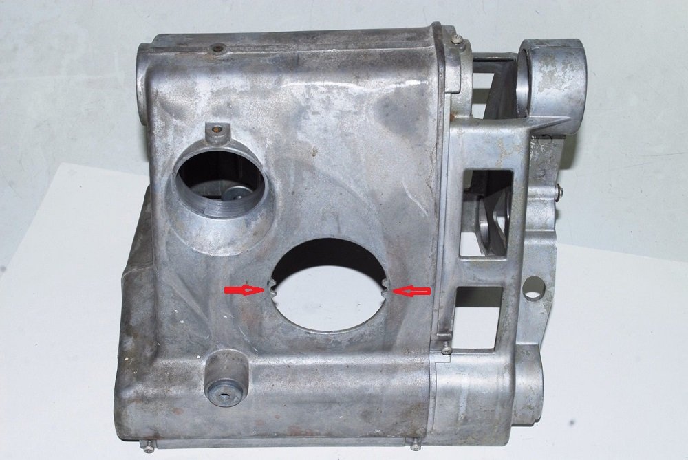

On the topic of the back view port thingy, is there anything preventing me from drilling a hole and 3d printing a dust cap? Can the 'A' headstocks be modified that way?

I recommend drilling a hole in the back of the headstock. Horizontal boring mode with a bi-metal hole saw would work great, if you had another Shopsmith :) I suggest drilling a circle of small holes carefully then file it round. The exact size isn't important. But having a hole there is very useful for routine lubrication and cleaning, plus replacement of any speed dial parts. Your machine might be so old you don't have lubrication holes on the shafts for the split sheaves. If not just apply lube to the shaft and work the sheaves in and out to spread it around.

Adding the access hole behind the logo plate on the back side of the Headstock can be done by marking the hole diameter and drilling holes around the diameter leaving a spot for the logo covers pins as seen below on the "B" Headstock in the picture. This is the same spot that the pins of the "A" Headstock cover go through. Filing can then round out the rest of the hole. The hole itself is slightly smaller in diameter than the cover.
_
Headstock B back tabs.jpg (99.79 KiB) Viewed 15860 times
Doing it this way you can get a logo cover from a "B" Headstock to replace the one you have. The only difference between the "A" and "B" Headstock cover is the addition of the retaining clip on the "B" cover that snaps it in place.
