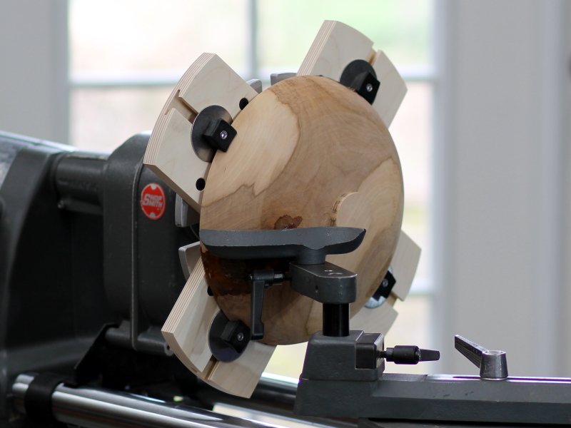

I have both, and have turned a few large bowl with them. Here’s a pic of a medium-sized applewood bowl with both accessories in action.
Bowl in extenders 2 LowRes.JPG (51.63 KiB) Viewed 33825 times
If I had to choose between the two, I’d defintely choose the speed reducer. The UTR is nice, but a large unbalanced blank spinning at 700 RPM on a lightweight machine is downright dangerous. And even if it weren't, it would still try to walk the whole darn machine to the other side of your woodshop.
I also use the speed reducer for large Forstner bits. It clamps tightly to the quill, so loosening the way-tube clamp for drilling really isn’t a problem, as the load is almost purely axial. And the bracket still slides along the way tubes, providing an additional measure of support.
