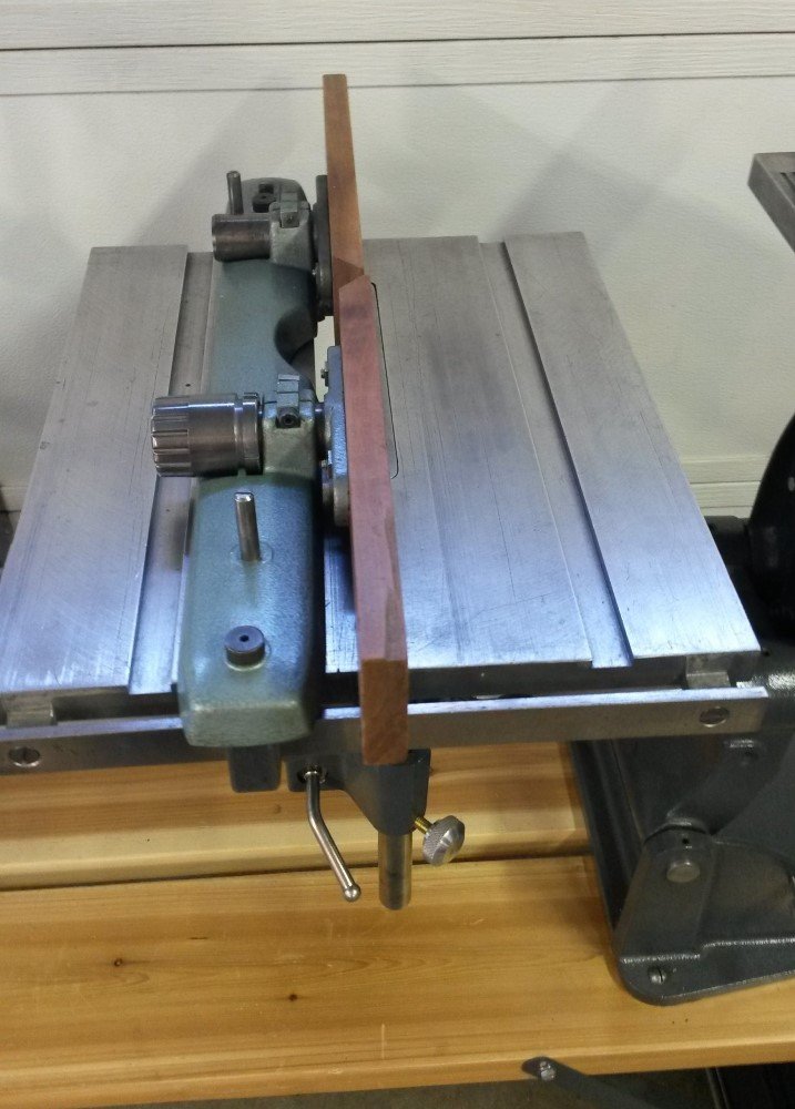

Thank you for adding the pictures. They are a great help in describing things. Shopsmith Mark 5 serial number SS 9405 would have likely been made in 1975. There are no records from that time period, so it is an estimate I have made. Hopefully included in the items you received are the Owner's Manuals for the different tools.
You asked,
_ .
If you are referring to the Shaper Cutters and Router Bits themselves, they use an arbor/spindle for the Shaper Cutters and a Chuck for the Router Bits.
You asked,
JPG answered about the Jig Saw Blades. As for the Shaper/Router Attachment if you mean the fence there is a picture of that below. It is the one for the original Table System but also fits on the Model 10E and 10ER shown mounted in the picture.What does the attachment for the shaper/router look like and what length jigsaw blade does it take?
_ .
