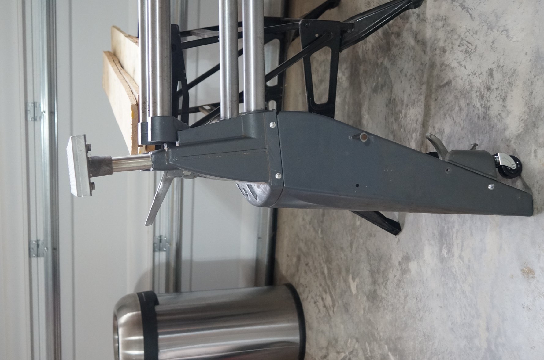

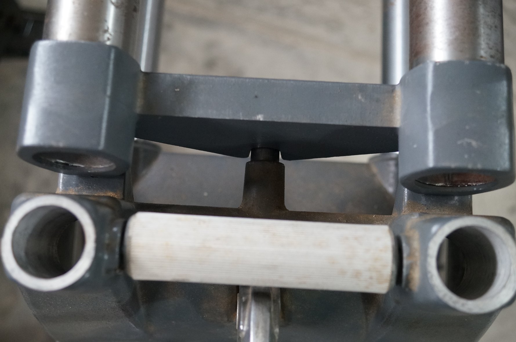

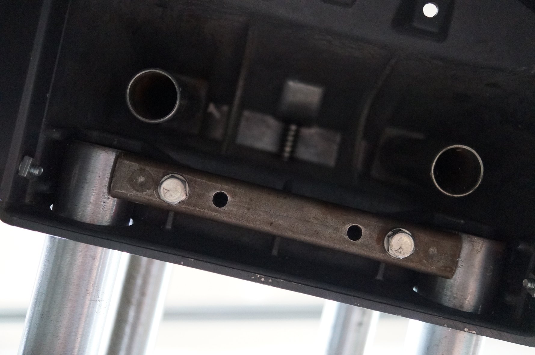

I recently moved and bought a used Mark V (1984 version) and took it apart to move it. My question is are the way tubes and the bed tubes different Lenths. I am trying not to take it apart again to find out. My end of the mark that the band saw goes on has a nasty tilt to it and the wheels on both ends barely touch the ground at the highest off the ground position. All tubes are fully seated.

Bench tubes are 3/4" longer than way tubes. Sounds like you'll have to take it apart to check.

Shop smith does not give the specs for wither tubs

Yep Had the longer ones on top...................in process of putting it back together
