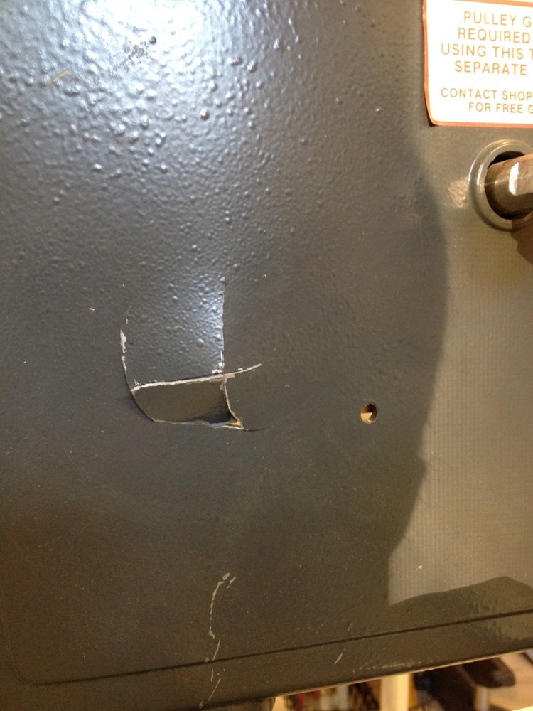

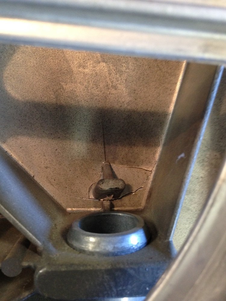

At some point it was dropped during shipment driving one Mounting Post up into the stop. This caused the damage to the Main Frame as shown below.
_
damage inside.jpg (120.02 KiB) Viewed 3728 times
_
damage outside.jpg (109.32 KiB) Viewed 3728 times
I replaced the Main Frame and now have a nice Bandsaw which has been my primary one since it's repair. The other two Bandsaws I have purchased that were shipped to me arrived well packaged with no damage.

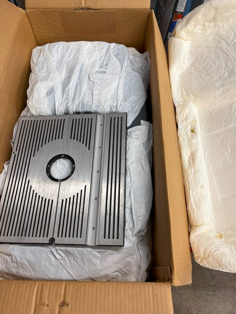

I measured the Shopsmith Bandsaw Box which is 34" x 18" x 11-1/2" and they use the expanding foam. The Table is placed above the Bandsaw. Although the one stored in the box I have it doesn't have anything but the plastic the Bandsaw is wrapped in between it and the Table. I would place some padding between them for shipping.

Packing this bandsaw turned into an adventure of it's own. I considered bagging and using spray foam but the space in the box from my DeWalt planer was tight. Instead I packed it with 2" foam insulation board on either side, filled in around the edges with 1" foam board, foam scraps, and some underlayment for laminate flooring. Closed up the box with some extra cardboard, the wrapped it with a mile or two of packing tape. Taking it to the post office tomorrow. Putting the table in it's own box. It's the cast iron version and very heavy but nice and flat.
My advice would be to get a bigger box, bag it and use spray foam, or make a wood crate. But this is why I don't want to sell stuff on eBay. Just too much trouble packing and shipping stuff. (This one was not a sale, just helping someone out.)
