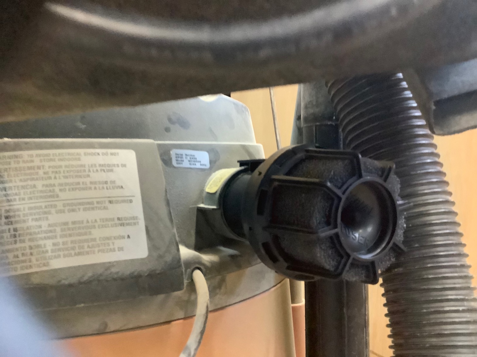

by wrmnfzy
As y’all can most probably tell I’m getting back in workshop after some extended time away. Trying to get gear back in shape. Here’s my latest query. I have a Rigid wet/dry vac and the foam in the muffler deteriorated. I can and did buy a replacement muffler BUT there must be some material I can put in the muffler that would replace the OEM. I’ve looked on line and in HD but noe for Rigid. I have also seen videos where they say it doesn’t muffle sound much, but it does stop as much dust from getting blown around until picked up. Any thought would be appreciated

I have one of those exhaust mufflers on my Rigid vac. It helps only a little with the noise, but it’s a pretty good exhaust-air diffuser. That’s some sort of open-cell foam inside the cage, but I have no clue where you could buy something comparable.

Buckeyedennis is what I have and yes I’m trying to find something I can use for the foam in the muffler, muffler is the terminology used by Rigid. It is what we are getting more use to having to buy an assembly instead of a much less expensive part.

The open-cell foam is similar to the foam used for aquarium sponge filters. It is available from many sources, including Amazon. Cutting it to fit might be a challenge, but you should be able to find videos that demonstrate this.
