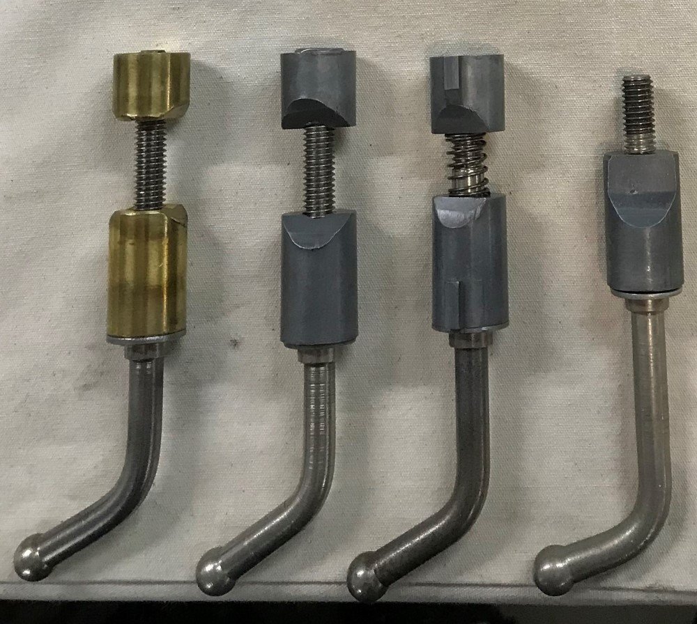

Below is a picture of the Single and Double Wedge Headstock and Carriage Way Tube Locks. The top and middle are the same lock but showing both sides of the wedge.
_ .
There was a brass Double Wedge Lock version used in the very first Model 10E tools made. You can see the brass wedges below in the different versions of the Quill Locks. Also notice the difference in the bend of the handles between the Quill Locks and the Headstock and Carriage Locks.
_ .
_ .
_ .

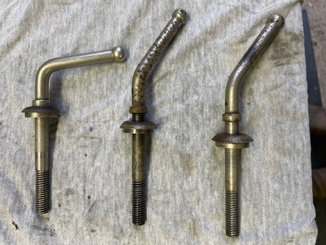

I forgot to mention that my head and carriage stock levers are the same as your first and second images.
As I will have to have the wedges remade, what material would you suggest and what are the inner and outer dimensions for the wedges?

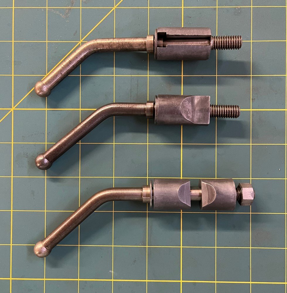

I have also attached an image of my three lock levers.
Regards Peter
Regards Peter

Your handles themselves appear to be for the Double Wedge Locks. The Quill Lock can have a larger angled bend but is further out the handle. See the picture below. The handles are a 1/4" with that thread size. The "washers" on yours are different than those I have seen on US made Model 10's. US made Model 10's have a plain washer with an inside diameter hole to fit on the 1/4" Handle shaft and an outside diameter slightly smaller than the wedges.
Here is where it may get tricky. There appears to be some differences between the US made Model 10's and the Australian made Model 10E. I can only give dimensions for US made Model 10's. The Australian Model 10E may be metric dimensions. I measured the Double Wedges and they are 7/8" in diameter. The rear wedge is 7/8" long for all three. The Headstock and Carriage front wedge are 1" long and the Quill front wedge is 1-3/8" long. The most important dimension is the wedge diameter to fit somewhat snug in the lock holes. The length of the wedges can vary slightly as long as their combined length does not exceed the Handles shaft and threaded end. If you are going to have wedges made, I would suggest making them out of brass like the original wedges. The rear wedges themselves can be threaded instead of imbedding a nut.

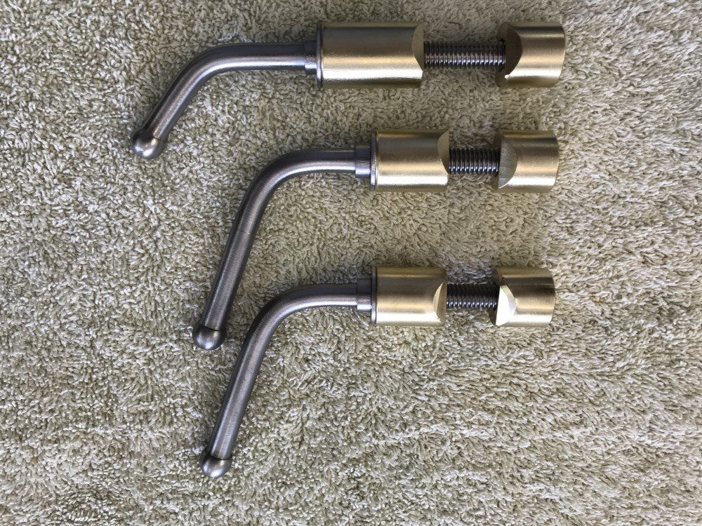

Below is the Lock Assemblies from my Model 10E and one of the original ones made from 1947. The wedges are brass. The top one is the Quill Lock. The Handles (levers as they are referred to in parts lists) changed somewhat over time. The ones below have more bend to the Headstock and Carriage locks Handles. The two of yours are the more common bend for the Headstock and Carriage locks Handles.
_
