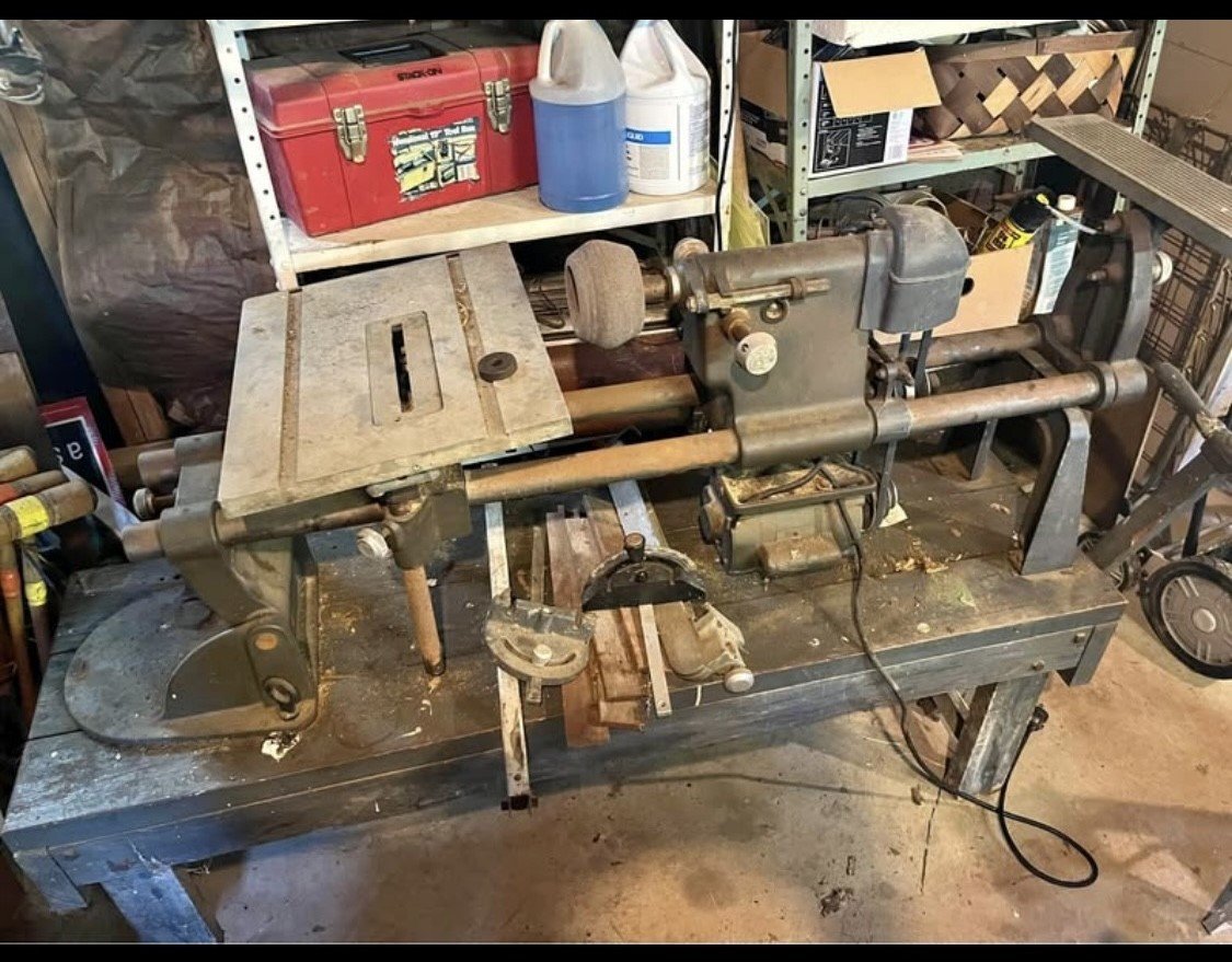

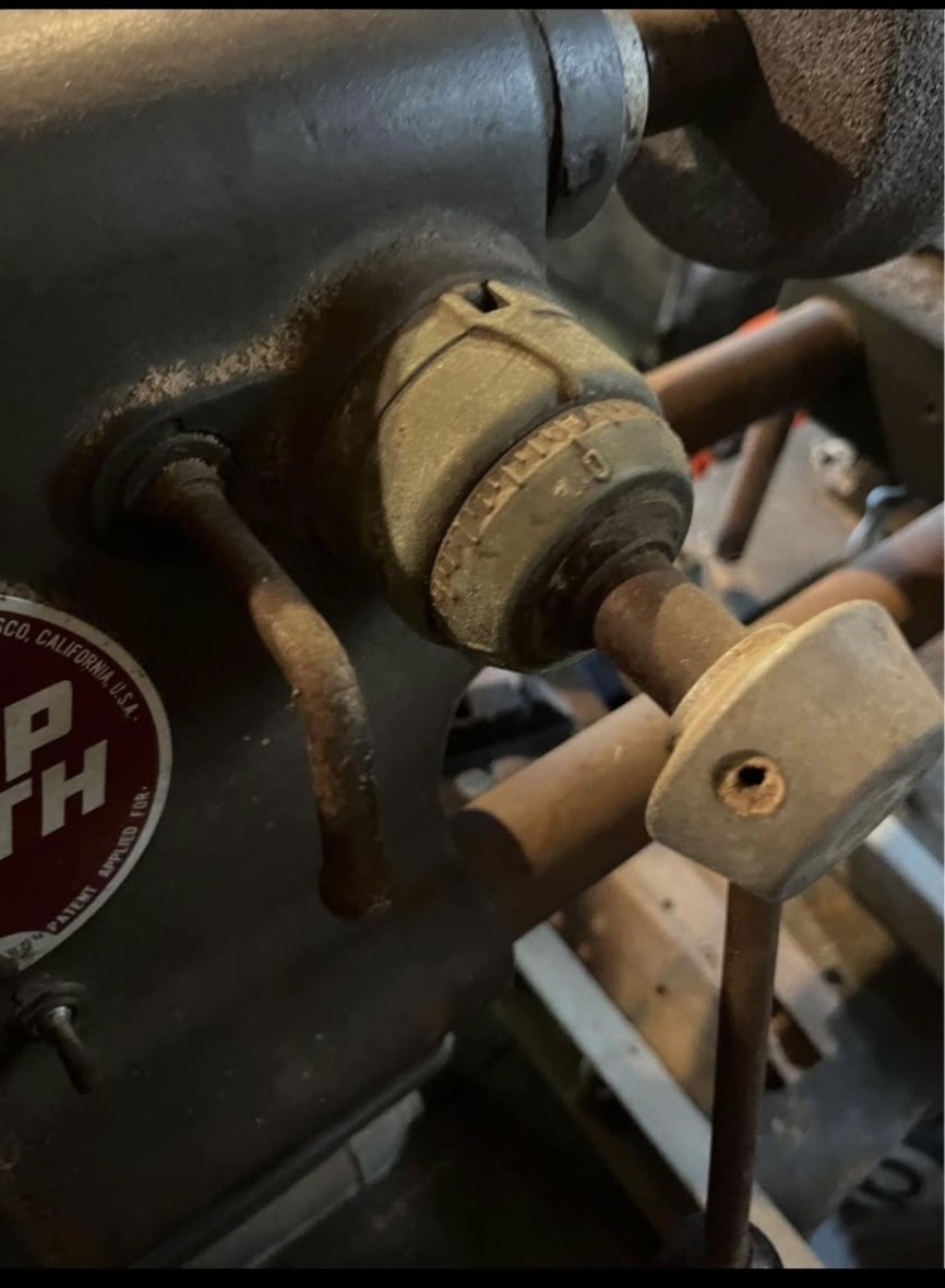

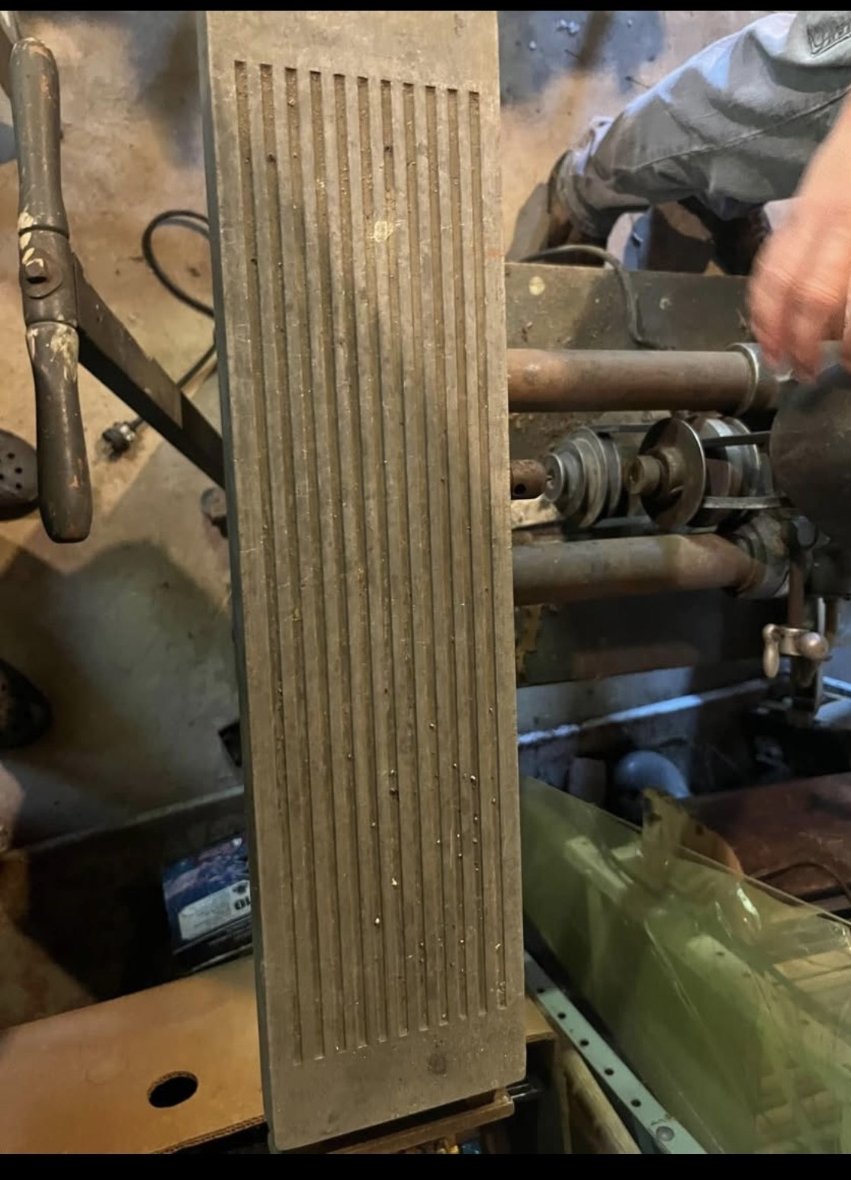

Well I am going after another one in the morning. :rolleyes:
This one has a Story also.
A very similar story of most of the ones I have picked up.
It belonged to the owners Grandpa that bought it new.
He (the Grandson) is selling it because he always thought that he would someday use it,
And it has just sat in his garage, and he has decided to let it go. :eek:

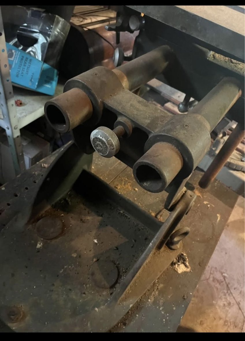

Here are some pictures from the ad.

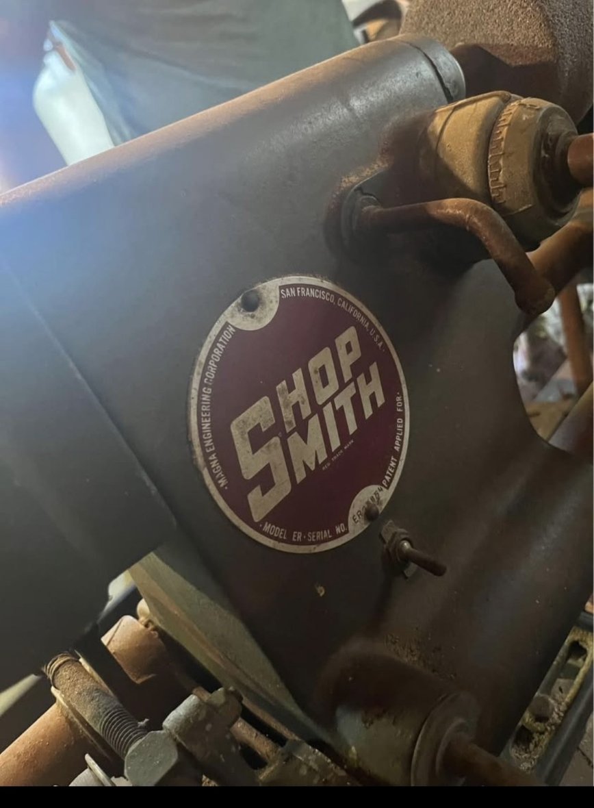

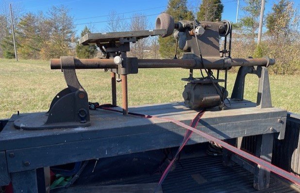

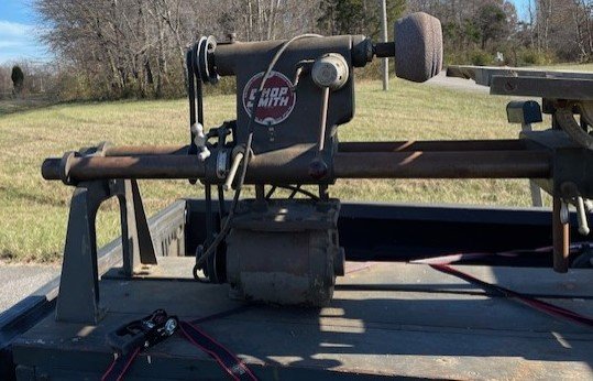

Well after a long drive to the middle of Ky.
I had a Great conversation with The Grandson that watched his Grandpa use this machine.
This was no doubt my Best purchase yet in my Shop-Smith journey.

I just picked one of the same models up yesterday. Other than a little saw dust, it looks very nice and neat. I see that the base it's sitting on looks like the one yours is on, which I guess is how they were shipped. I thought that maybe the person who I got it from built the base. Thats pretty neat history!

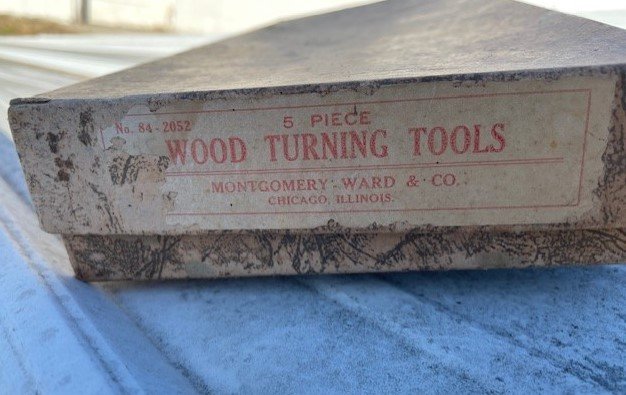

From the paperwork and the chisels his Grandpa probably bought it from Mongomery- Ward.

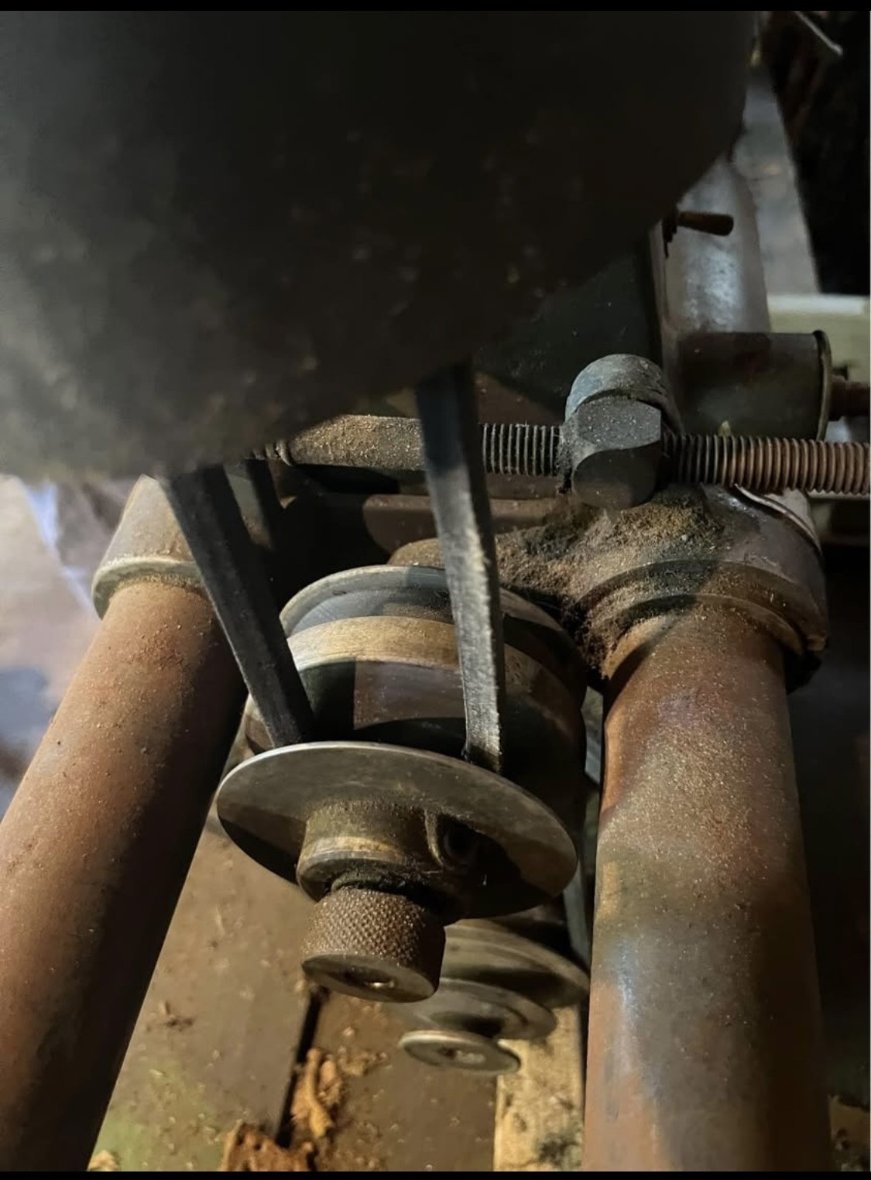

I hope you got it for a reasonable price. The extra Speed Changer Belt 4L260 is longer that the more common 4L250 and appears to be longer than it should be if the one currently on the Speed Changer is the same 4l260 size. That would be the reason the Motor is hanging so low below the Headstock.

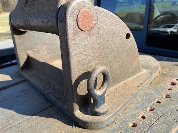

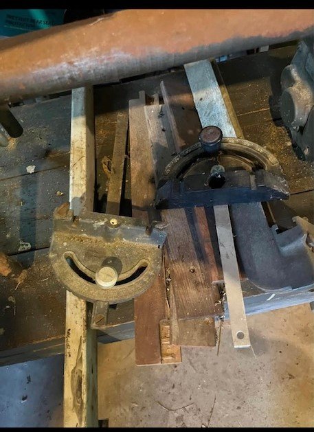

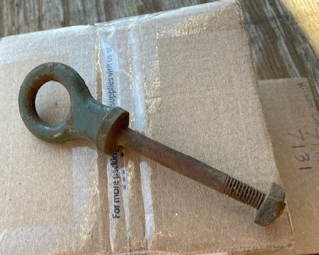

Looks like you got another non-Shopsmith Miter with this Model 10ER. It is an interesting I-bolt used on the Base.

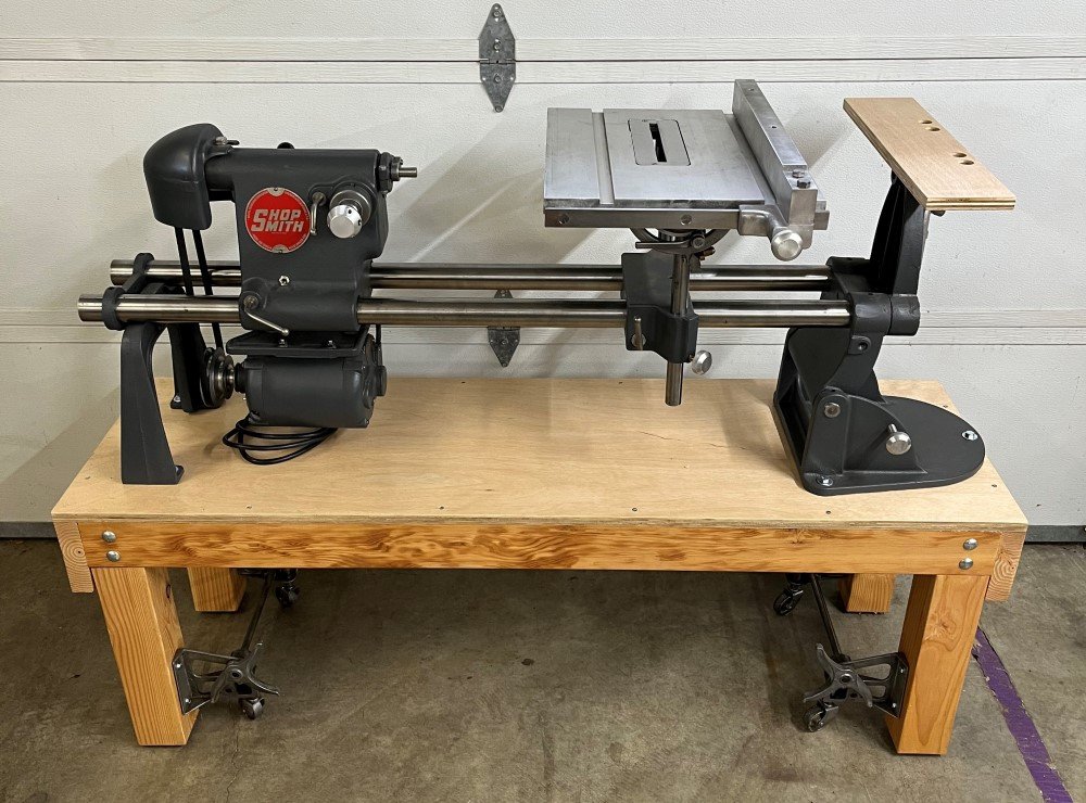

The Shopsmith Model 10E and 10ER was shipped without a bench. It was up to the owner to make one for it. The blueprint for the Bench GetterDone shows is one of two versions provided by Magna Engineering Corporation as a suggestion for a Bench. Below is a picture of one of those Bench suggestions I made for my Model 10E's.
_
1077 on Wood Bench.jpg (169.94 KiB) Viewed 8323 times
Attached is a PDF of the Bench Plan I followed.
Shopsmith Bench Plans 160-2 4x4 legs.PDF
(2.18 MiB) Downloaded 444 times

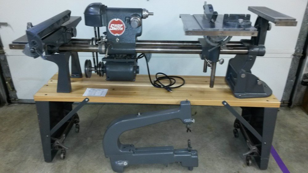

It is slightly different in the legs than the one GetterDone shows the blueprint of which is the other version. Once Magna Engineering Corporation introduced the Metal Bench Ends Model 10's were more commonly put on that type of bench. A Model 10ER on the Bench with Metal Bench Ends is below.
I got it for about the Price a Speed changer goes for.
With the Information you and JPG gave me about the belts . :D
I noticed that that Motor was Almost touching the Table. :eek:

The non-Shopsmith Miter I think goes with a Table saw that was in this shop. :)
There was also a fence that I acquired that probably goes with that table saw. ;)
The I-Bolt has a part number on it.
They are probably not SS stuff :D although very cool and will have to be incorporated in the restoration.
