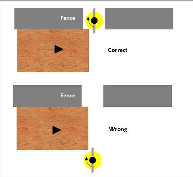

Hi,
Even for experienced router users getting the direction of either moving the work piece or the router can be confusing. When you start adding things like jigs and fixtures and the like it gets even worse.
A good basic step is to keep in mind a good reference. Like the hand references in electronics, if you take your right hand and make it look like a backwards letter L (other finger hidden). If the router bit is above like in a hand held router or say the shopsmith the thumb references the bearing surface and the first finger points the direction of feed. If the bit is below like in a router table then the left hand is used.
In cases where the bit is cutting with material on both sides you can feed either way. But for the sake of habit you would normal feed in the same direction as you would according to the rule.
In cases where additional jigs are in place like the case of either the incra or jointech you follow their instructions... like backing the bit out of the cut under power, normally a no-no. You will also need to following the directions for the first and last cuts if they are not embedded....
As for the shopsmith images, 10-4 looks like to me a case where there is material on both sides of the bit... however for this to work well the fence and miter slot have to be aligned pretty well and I would worry about the lack of support for the workpiece at the cut as well as the lack of a backer board to prevent tear out.
The picture 10-19 shopsmith will have to defend... not a cut I would do that way.
If you are interested here is a link that might be helpful:
http://www.routerworkshop.com/direction.html
And a visual
[ATTACH]4553[/ATTACH]
And a visual
- router direction.jpg (92.35 KiB) Viewed 4135 times
