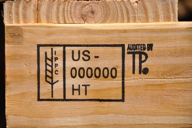

It may be too late to know or check this if the pallet has been cut, milled, sanded, etc., but if the pallet you used had the "HT" mark on it (see link below) then there is a good chance that it is safe and hopefully hasn't been impregnated with methyl bromide or some other pesticide. I really wish that YT'ers and other social media would stop suggesting pallet wood as a source of free lumber, or at least they should point out the potential risks of using it. Anyway, I hope this helps. Another thought is to just put some masonite on top of it as JPG did with his workbench. My main concern is for any woodworker to NOT inhale the sawdust that contains methyl bromide or any other toxic wood treatments.
https://www.palletone.com/heated-treated-pallet-stamp/

Thanks! Good to know. Sometimes I see pallets stacked and sitting outside here at some companies in their parking lots. I also wonder if any of them ever choose to spray them with pesticide as a post activity, i.e. while being used - waiting for their next use. I have no proof of this, but just a curiosity. That is why I stated the ISPM regulation, but didn't know how/when it applied. I agree with you on the quality of pallets. As a consumer, I am rare in that I have had several pallet shipments to my home via freight over the years. Most of the pallets were quite abused and I just disposed of them. One was remarkably better than the rest so I saved it and made it into a storage shelf suspended from my garage ceiling. It has the heat treated stamp on it, similar to the pic I showed up above. Now, this wasn't an international shipment, so perhaps international pallets get re-purposed sometimes for domestic shipping? IF so, kind of gets back to my point of being careful on using pallet wood for anything unless you know whether it is good or not and what treatment(s) it has had, if any.
