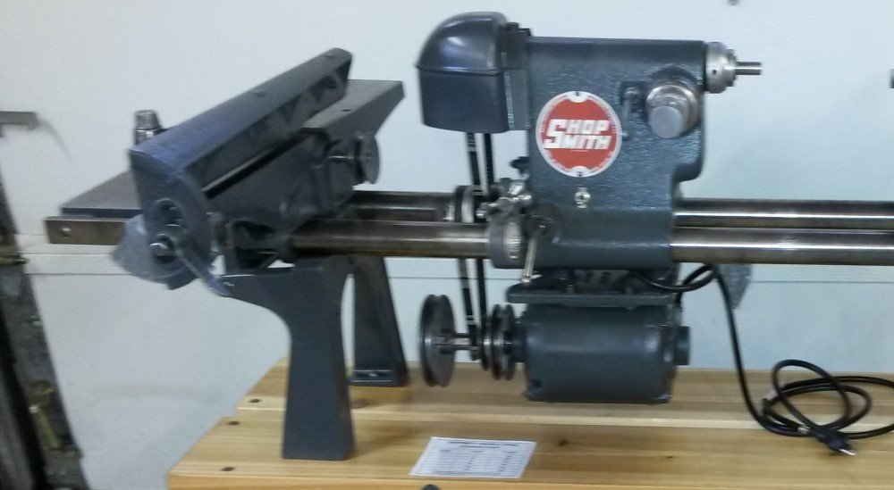

Judging by the serial number 85065 that Model 10ER was made in late 1952 or early 1953. It looks to have most of the basic items it would have come with from the factory plus the Magna 4" Jointer Mount Headrest and Jointer Cutter Guard. If it includes that Jointer and the other related parts, it is a plus. The picture below shows the Magna Model 4E Jointer mounted on a Model 10ER but without the belt between the 5" Motor Pulley and the Jointer's pulley.
_
R64000 with Jointer.jpg (79.78 KiB) Viewed 34783 times
I do have that 32” Belt (4L320) and have used that Jointer. When using the Jointer, the belt between the Motor and the Speed Changer or the Headstock (without a Speed Changer) can be removed to reduce drag from the moving parts of the Speed Changer and/or Headstock.

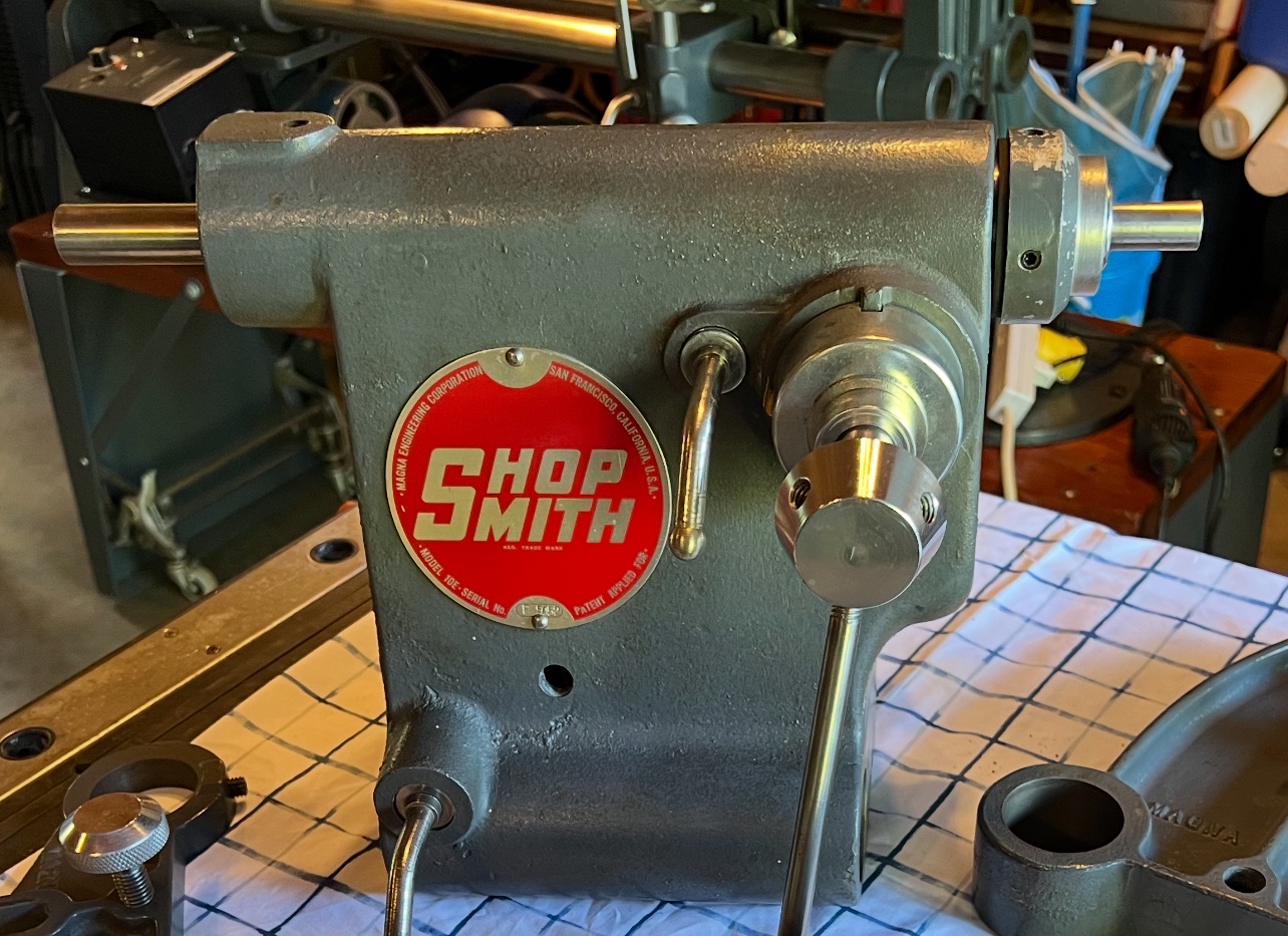

While it’s interesting to have a 10ER with the jointer package included, this unit does not strike me as a good condition machine. And I will say, I’ve acquired quite a number of poor condition vintage Shopsmiths for restoration (haven’t lost a patient yet!), but they have to be cheap-to-free for me to even consider them…
Not sure if it’s an illusion, but one of your pictures appears to show the spindle missing from the headstock!! It should look like this:
I love 10ERs - I have 3 restored and running in my shop - and I highly recommend them. But I think there may be better values out there for one of these, so give it a really critical look before you buy…
Good luck!

I’m glad you mentioned that. I went through our conversation and the seller did state that there’s a new spindle included, as something in the original was bent. It just needs to be installed.
I appreciate the advice and I’ll absolutely keep that in mind!

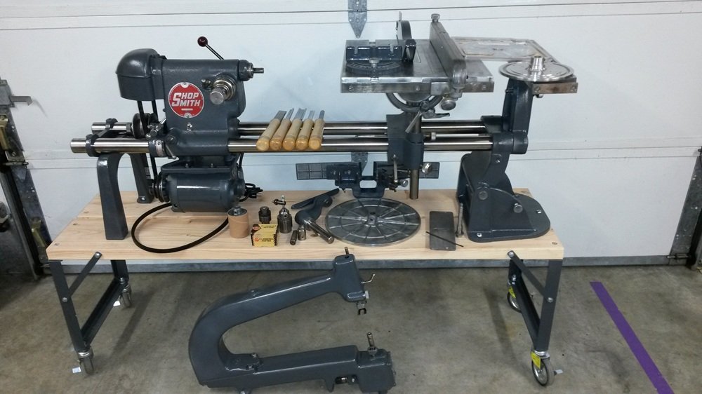

There are things that will have to be replaced during its restoration. The Headstock Pulley has a chip out of it. Hopefully the replacement Spindle/Quill Assembly is okay. I have had a bent Spindle on one of my restorations. It may need new bearings. There are items needed to use just the basic functions for this Model 10ER that are not shown in the pictures like the Arbor, Drill Chuck, Sanding Disk and Lathe Drive. The less complete it is the more it will add to the overall cost.
That price is more than I sell a restored Model 10E or 10ER complete with everything as it came from the factory plus on a bench. I don't sell my restorations to make money but do like to recover the costs. I do it because I enjoy working on these tools. Unless there are items included that are not shown I personally would not buy that Model 10ER as a restoration project. Additionally, I wouldn't pay anywhere near the asking price.
Below is a comparable Model 10ER I restored to the one you are looking at. It includes all the accessories it came with originally plus a Speed Changer, Jig Saw, Jointer-Shaper Fence & Jointer Cutter Head, Drum Sander and Lathe Chisels. These extras all add to the value of this Shopsmith.
