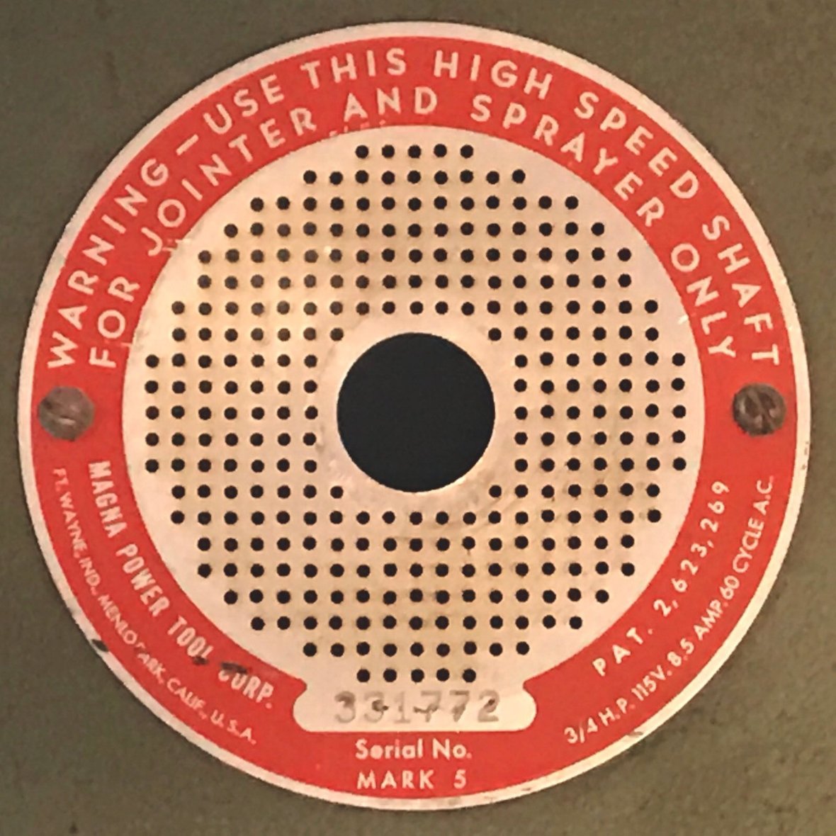

Serial Number 336034 was made around October 1956. That is an estimate because that range is part of the missing serial numbers by month. It should have a Vent/Serial Number plate on the Belt cover that looks like the one below.
_
331772 Mark 5 Greenie est Sept 56 West Layafette IN.jpg (208.72 KiB) Viewed 32476 times
That Mark 5 would have been painted in green and silver from the factory and is commonly referred to as a Greenie.
Gilmer Belts are still available and most are found at online auctions. The Gilmer Drive Sleeve Assembly for your era Mark 5 would be the clutch type. The Mark 5 changed to the Poly V Drive, which is still used in conventional Headstocks today, in 1961 just after the change to the 1-1/8 HP Motor. Something to consider is if your Mark 5 needs replacement parts like bearings and the Gilmer Belt you could upgrade to the Poly V Drive. This would require a different part on the Idler Shaft Assembly for the Poly V Belt. A Poly V Drive Sleeve Assembly and a matching Quill Assembly either a single or double bearing one. The double bearing Quill has less runout. The number of splines on the Quill's Spindle Shaft changed with the change to the Poly V Drive. These parts could be purchased new or used if looking to save a bit. Just use caution buying used parts as the actual condition is unknown. Many Mark V users have upgraded to the Power Pro DVR Motor so many of the parts to upgrade to the Poly V Drive are for sale by those wanting to get back a little of their investment in the Power Pro by selling those no longer needed parts.

Russ, thank you again for the information about the Mark 5. My machine does have the vent plate with the serial number just like you show.
