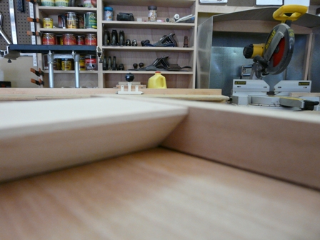

[ATTACH]4672[/ATTACH]

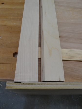

Tom I start with a groove in the sides and bottom of the cabinet for the back.
[ATTACH]4673[/ATTACH]

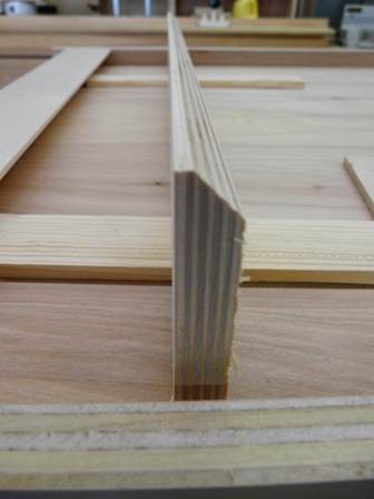

The back then slides into the groove.
[ATTACH]4674[/ATTACH]

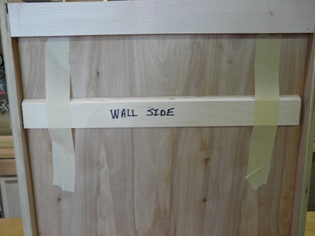

This is the upper part of the wedge bracket. It is 3/4 x 2 1/2 inches.
[ATTACH]4675[/ATTACH]

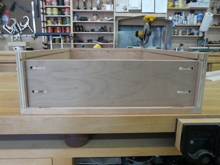

It is nailed and screwed into place in this position at the top of the cabinet.
[ATTACH]4676[/ATTACH]

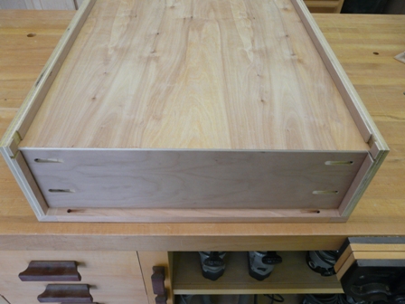

This is the wall cleat part of the bracket. It is 1/2 X 2 1/2 inches

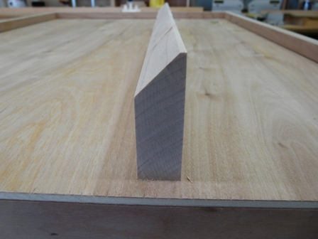

[ATTACH]4677[/ATTACH]
It attaches to the wall and the other bracket slides down onto it, wedging the two together.

MARK: What is the UPPER wedge nailed/screwed to? The back? The sides? The top? Is the back ever 'permanently' attached to the sides? Pretend I like burning sul.. black gunpowder!

OK lets clear the black smoke!:DThe top nailer is brad nailed and then screwed into the top shelf through the 1/4 in back. That locks everything in place. I use screws because this piece carries the weight of the cabinet and all the contents.
Mark
