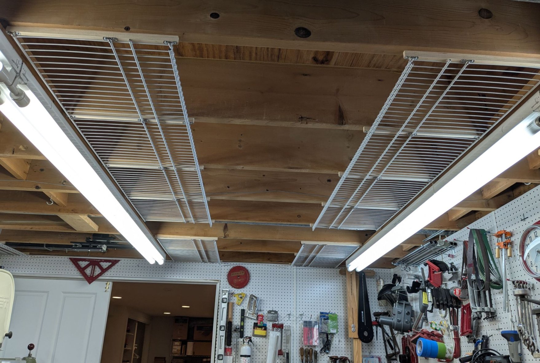

... and not too proud to steal someone else's idea. I often stash random junk between the overhead joists in my basement workshop, but it wasn't exactly user-friendly space. At least not until I found the following idea online.
After a lot of searching, I found some one cubic foot plastic storage totes on Amazon the were almost a perfect fit for the between-joist space, except for being a tad too tall. No problem, I said to myself, I'll just fir the shelves down 3/4" from the bottom of the joists.
Although making firring strips isn't exactly fine woodworking, I needed 31 of them, each with six clearance holes for the mounting-bracket screws. Now mind you, drilling 186 reasonably-accurate holes overhead was not my idea of fun. So I decided to pre-drill all the holes in the firring strips prior to installation, and then use them as guides for driving the shelf-mounting screws. But even using a Shopsmith in drill-press mode, that still didn't sound like fun. So I decided to delegate the drudgery to my CNC router.
Oh yes -- much better!
Here are some of the shelves after installation.
Shelves 1.JPG (394.23 KiB) Viewed 36614 times
And a close-up of the U-brackets I used to mount the wire shelves -- also an Amazon find.

And finally, as much space organization as I can muster up. In addition to the content labels I stuck on them, you can see right through the clear-plastic ends and bottoms of the totes, making it a lot easier to find stuff.
Shelves 3.JPG (235.37 KiB) Viewed 36614 times
The plastic totes were the bulk of the expense, at about $12 each. All told, I added a little over 20 cubic feet of flexible storage space to my shop for less than $400 total, including the plastic totes, wire shelves, and mounting hardware.

Great idea but sheetrock gets in the way in my garage.

Matanuska wrote: Wed Apr 16, 2025 10:48 pm Great idea but sheetrock gets in the way in my garage.
Yep, you definitely have to have exposed joists for this to work!
My shop ceiling is perfect for this. It's beneath our slightly-sunken family room, so the bottoms of the joists are only about 7-1/2 feet above the shop floor. And I'm a tall guy, so I can reach the totes pretty easily while standing on the floor.
