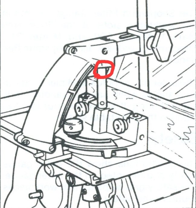

The area where my miter gauge is loose is at the interface area circled. Everything else is nice and tight, but the handle area between the upright post and the casting doesn't appear to be worn, it just doesn't fit correctly. I'll try to get some photos later.

dablakh0l,
You last post helps explain it a lot. Pictures/drawings always help.
That point in the Safety (Hand) Grip is a bit loose. I don't know why the tolerances are not "tighter". Maybe to avoid binding when attaching the Grip to the Miter. Do make sure the post is tightened to the Miter's Protractor (the Allen Wrench through the hole in the post is good for that) and the screw is tight where it attaches to the Block. Once the hold-down has pressure on the stock to be cut it will hold it in place against the Miter.

What bothers me is that the grip is sloppy loose everywhere. When you pick up the miter gauge it wobbles side to side. The casting at the bottom where the screws go through the indicator mount is not even tight to the indicator mount, and everything feels extremely cheaply made. I don't know if this is common or not, but it just feels off.
- Posts: 4538
Re: The handle on my miter gauge is loose.
I checked several of mine and they very in how loose they are. I have ones ranging from Mark 5 Greenies up to more current ones. Some were not loose in the mountings at all.
