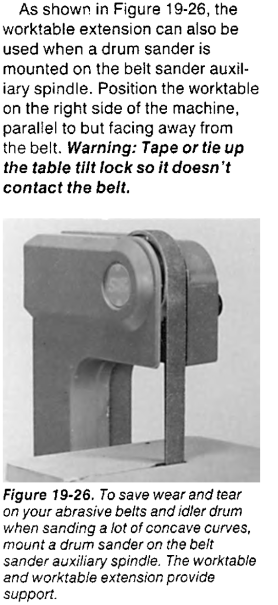

Hmm, was just looking at that version in the link. I think this might be a bit of an error
Screenshot 2025-06-03 at 1.40.59 PM.png (316.37 KiB) Viewed 75330 times
(And no surprise -- my print copy is the same)

HopefulSSer wrote: Tue Jun 03, 2025 1:43 pm Hmm, was just looking at that version in the link. I think this might be a bit of an error
Yeah, wrong sander. The belt sander can be mounted on either side of the headstock so it does have an auxiliary spindle. The standard strip sander doesn't but I modified mine to mount the other way so it does have an auxiliary spindle now. Described in this thread- Strip Sander wheel and bearing.

As for HopefulSSer's post above that is an oops made to the current version of the 4th edition of Power Tool Woodworking for Everyone and the original 4th edition has the correct picture in Figure 19-26.
