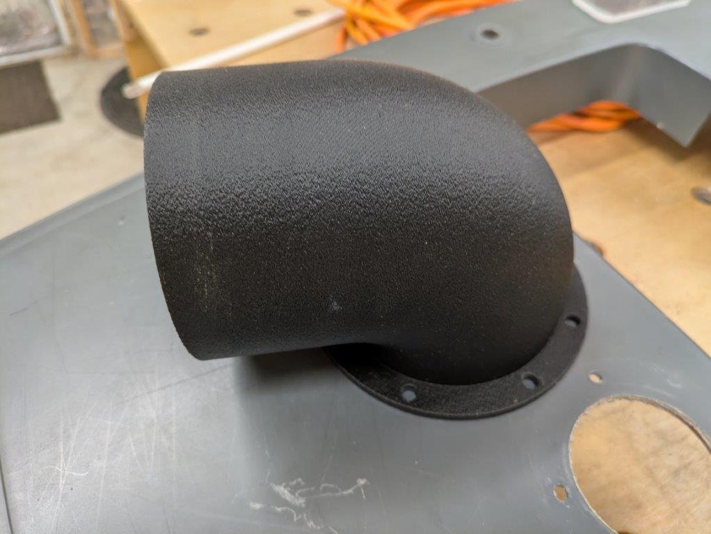

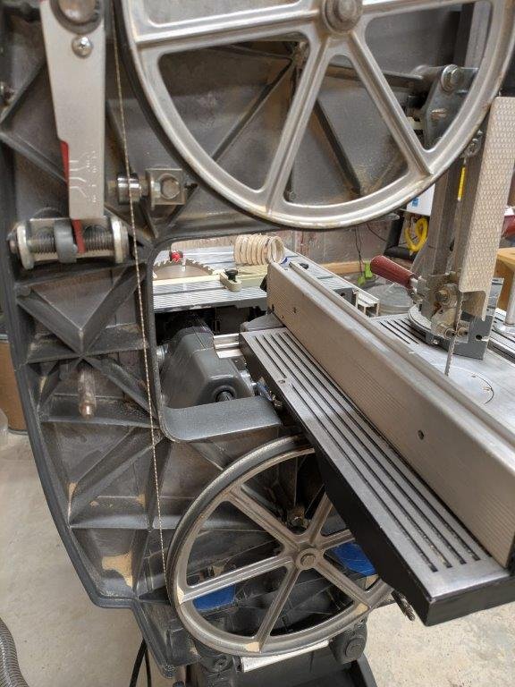

I figured I'd start with the easy one and convert the bandsaw adapter to 4" . My kid recently upgraded his 3D printing capabilities and I took advantage.
Heres the new adapter compared to the existing 2" port opening. Printing has come a long way..adapter is solid and a nice texture has been added.
He will be adjusting the screw holes and added a slightly smaller diameter to the hose mounting section.

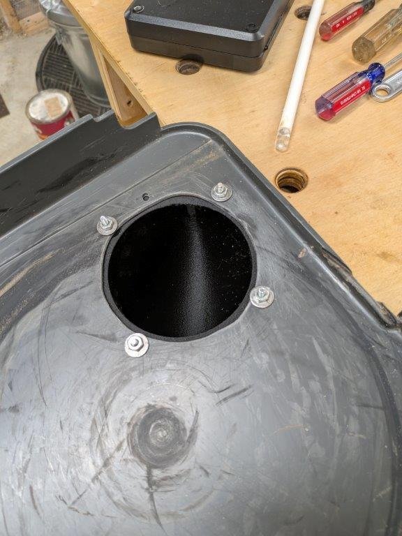

Sketch of how big the adapter will be..i chose to use at least one of the existing screw holes from the 2" .
bs adapter 2.jpg (54.94 KiB) Viewed 79323 times

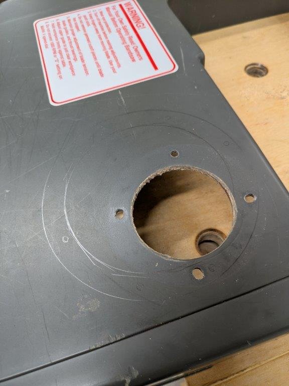

Mounting outside
bs adapter 3.jpg (60.25 KiB) Viewed 79323 times

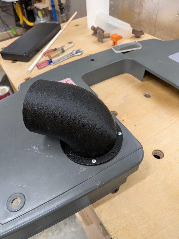

Mounting inside
bs adapter 4.jpg (75.8 KiB) Viewed 79323 times

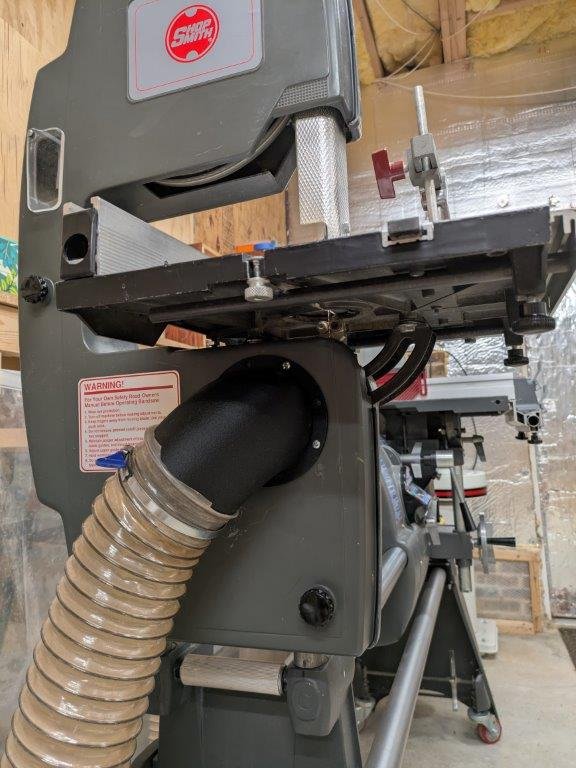

Hookup
bs adapter 5.jpg (83.35 KiB) Viewed 79323 times

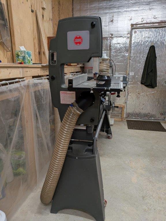

Full View- my old 4" to 2" adapter is sitting on the bandsaw table.
bs adapter 6.jpg (85.44 KiB) Viewed 79323 times
I haven't had time yet to run the saw and see if collection is improved/reduced or no change.
Will report back once I have tried.

I finally had some time to run the bandsaw with the new 4" adapter.
This is after a weekend of on and off use , not heavy use but typical of my work loads.
I think the 4" adapter is doing a much better job than was the 2" adapter which showed alot more accumulation in the nooks and crannies.
The last thing I want to do is place a toothbrush or similar to rub against the wheel and flake off any dust particles that adhere to the rubber.
For anyone considering the 4" vacuum adaption to the bandsaw, the kiddo tells me he would be willing to print these adapters for $35 plus SH.
