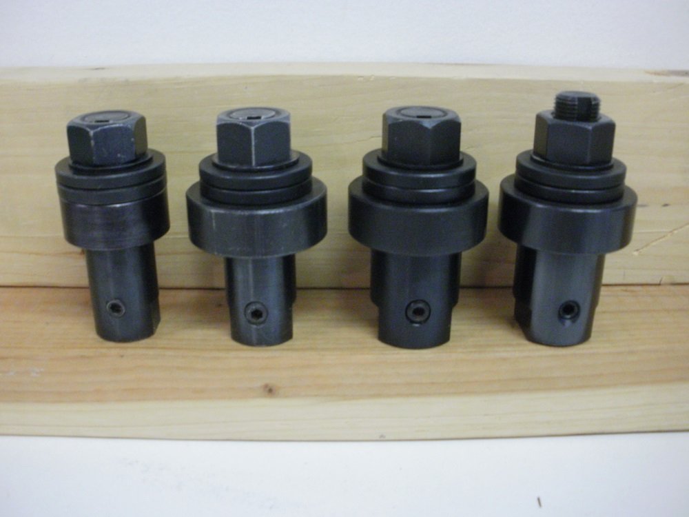

You would need a Dado Arbor. From Shopsmith that is part number 505506 the Molder/Dado Arbor previously known as the 5/8" Universal Arbor. There have been 4 versions of it with that part number (505506) since 1964 as seen in the picture below.

- 505506 V1-4 r.jpg (71.38 KiB) Viewed 99629 times
Prior to the change in 1964 there was 3 versions of a 5/8" Universal Arbor simply called the 5/8" Arbor and were part numbers (in descending order) 22 031, 12 031 & 126-1X. Those three did not have the black protective coating which also started in 1964. The picture below shows those 5/8" Arbors plus some others used for different purposes.

- Arbors page 1 - labeled.jpg (150.85 KiB) Viewed 99629 times
