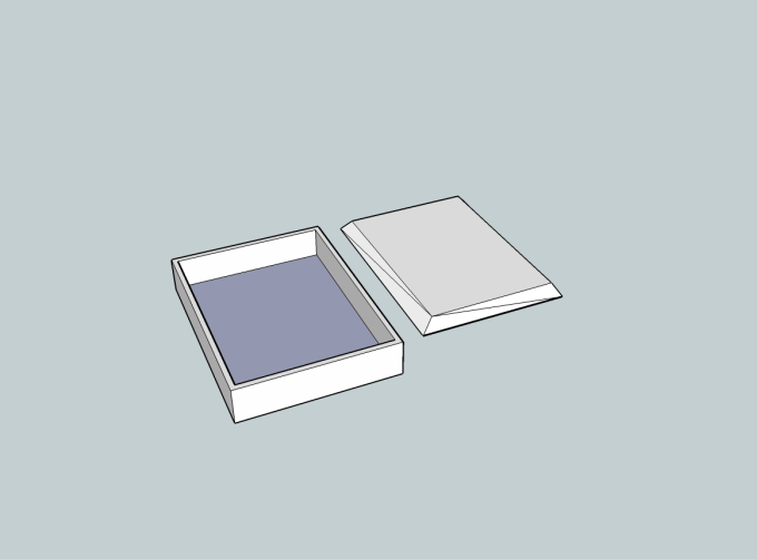

I was going to build a box with a sloped sides only (front/back/ lid all straight). I saw where I could make a taper jig. Why not just use the miter gage or tilt table? The box is going to be about 6-8 inches tall x 10 inches deep x 12 inches wide. The angle would not be a full 45 degrees. Still deciding on that. Depending on if I need a taper jig or miter. I can adjust the angle based on the answeres to this thread.

I think, from your description, that you want to put a slight bevel on the edge the top so that the top surface of the lid is slightly smaller than the base of the box.
If this is correct, you can certainly do that by tilting the table. You could also do that on the jointer, if you have you.
[ATTACH]4860[/ATTACH]
Box and Lid.png (33.11 KiB) Viewed 5969 times
