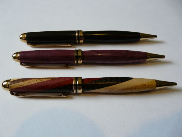

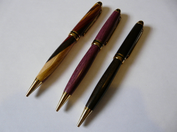

Three of the four pens I turned this morning while waiting for paint to dry.
[ATTACH]4917[/ATTACH]
[ATTACH]4918[/ATTACH]
They are from back to front Blackwood,Purpleheart, and a laminated blank from Woodcraft.

Great looking pens, Mark! Nice job! What kind of finish did you use?

George I have been experimenting with different finishes on my pens. These three have 6 coats of lacquer sprayed on while turning at low speed. I cant handle the fumes when finishing with CA glue, so I am trying to come up with something harder than Huts polish with a good feel. These came out pretty nice.
Tom nice pen you have and a good looking finish. Blackwood and Ebony are not the same wood. Blackwood is not as dark or as black as Ebony.
