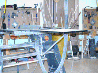

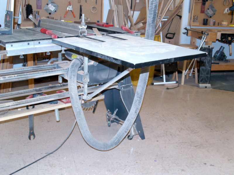

My co-instructor, Drew Achtermann, likes the Shopsmith outfeed table but got tired of running around to the back of the Shopsmith every time he needed to change the table height, tilt the table, or move the Shopsmith. Here's his solution and it works like a champ. The outfeed table raises, lowers, tilts, and moves with the Shopsmith. Furthermore, it can be folded down, out of the way, in just a few seconds and completely detached from (or re-attached to) the Shopsmith in less than a minute. And because the outfeed table is supported by a brace that is triagulated off the main table support post and both tables are tied together in a single assembly, the setup is actually sturdier than having the outfeed table resting on it's own dedicated leg.
Here's a static photo and an animated gif to show you how it works. This same concept, by the way, would work for either an infeed or an outfeed table.
[ATTACH]136[/ATTACH]
[ATTACH]135[/ATTACH]
We've worked with this design for about 4 months at the Academy and have found that it makes the outfeed table much easier to use. The students who have used it seem to agree.
