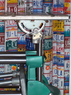

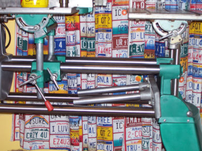

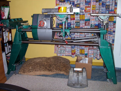

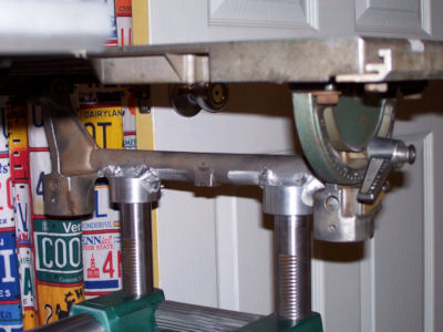

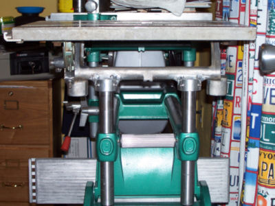

WE have all wished for more table on our ShopSmith's (or at least I have).
I saw on billmayo's web site a table mod he had done to allow the work table to mount into the headrest or base. I liked the idea but I wanted somthing that would center up on the sanding disk or drill press better.:confused:
I felt bringing both legs in to keep the table centered would work better. By leaving the original tube mounts in place structural integrity would be less likely to be compromised (or at least that my story and I'm sticking to it:D ).
I wanted to retain the ability to align or tilt the table and the ability to move the legs back to the original location if needed.
This is what I came up with.
[ATTACH]4958[/ATTACH][ATTACH]4959[/ATTACH]
[ATTACH]4960[/ATTACH][ATTACH]4962[/ATTACH]
[ATTACH]4961[/ATTACH]
I still need to clean up the welds a bit and paint everything but I belive it turned out pretty good.
I will be using this on My 59 mini as a work table, or as an extension/support table on my 520 if needed.
