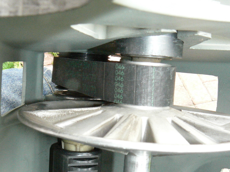

Position the bearing eccentric bushing onto the idler shaft bearing with the adjusting slot facing the end AWAY from the pulley. From the INSIDE of the headstock Slip the Drive belt(poly-v/Gilmer) onto the grooved/cogged pulley. For THIS vintage Poly-V belt the belt should be positioned so as to just cover the third GROOVE of the pulley on the drive shaft(upper)(there should be two GROOVES showing on the end of the drive pulley facing the quill handle etc.).

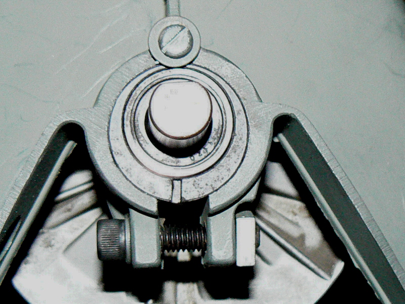

Rotate the eccentric bushing so the 'fat' side is towards the bottom of the headstock, and slide all this into the bore.
Notice the groove in the center of the bearing. This groove allows the set screw which has a cone shaped end to position the bearing in the eccentric sleeve and secure it. DO NOT overtighten this setscrew as it might apply too much pressure on to the bearing.

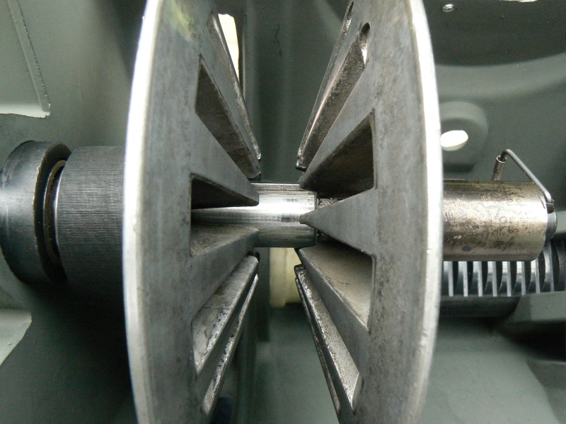

Slide the Control sheave onto the idler shaft. The shaft has a key and the sheave has a keyway slot which must be aligned. This would be a good time to lubricate the control sheave/shaft. Finally slip the Motor belt over the control sheave/shaft.
Check the alignment of the drive belt from pulley to pulley. SOME later Mark V require positioning the poly-v belt one more groove towards the rear.

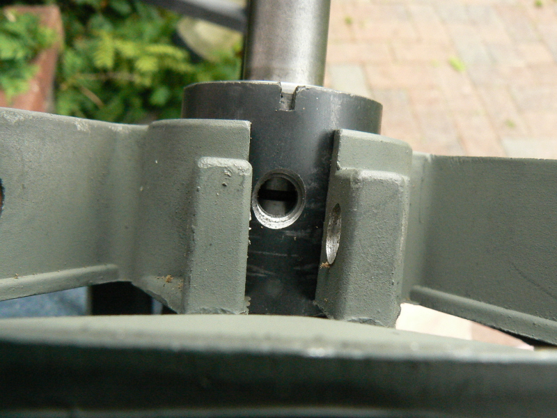

If there was a screw/washer at the top of the idler shaft bore replace it and tighten. Snug the bolt securing the eccentric bushing. If adjusting the drive belt tension now, rotate the eccentric bushing until slight pressure deflects the drive belt about 1/4". This pix shows the eccentric bushing before tensioning drive belt.
