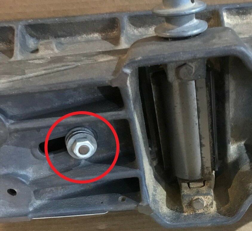

by chapmanruss
Use caution trying to get the Knives out of the Jointer Cutterhead. Even dulled Knives can cut through skin. Having the Cutterhead out of the Jointer would make it easier to push the Wedges up and out from underneath with something like a flat screwdriver. Push up only on the Wedge. The Knives are slightly wedge shaped too. To remove the Cutterhead from the Jointer requires separating the Infeed Table from the Base/Outfeed Table. To do that remove the nut and 5 washers shown in the red circle in the picture below. Once the Cutterhead assembly is removed you may need to remove, by sliding off, the Bearing Housings (mounting blocks) to get to the underside of the Wedges.
When reassembling the Jointer stack the washers in the following order, flat-spring-flat-spring-flat. The Spring Washers are rather thick but have a waviness to them. Do not over tighten the nut or the Infeed Table will not move to adjust the depth of the cut. Before reassembling I would recommend cleaning and waxing the contact points between the Infeed and Outfeed/Base Tables.
