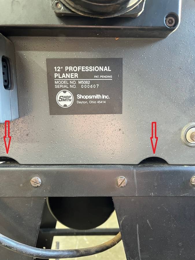

I decided to post some pictures to help. The first is from a Pro Planer showing the points on the side (called the End Frame) where it would sit on the Way Tubes indicated by the arrows.
_
Mount indents.jpg (98.56 KiB) Viewed 6688 times

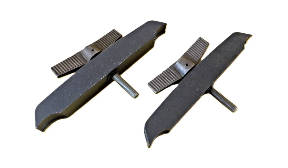

Below are the clamp sets to attach the Planer to the Way Tubes.
_
Planer Mounting Clamps.jpg (37.96 KiB) Viewed 6688 times

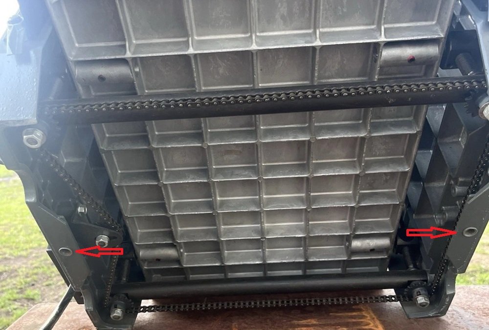

The picture below shows the underside of a Mark Mount Planer. The arrows show where the clamps attach to the Planer. They are the same threaded holes used to attach the Pro Planer to the Stand with bolts.

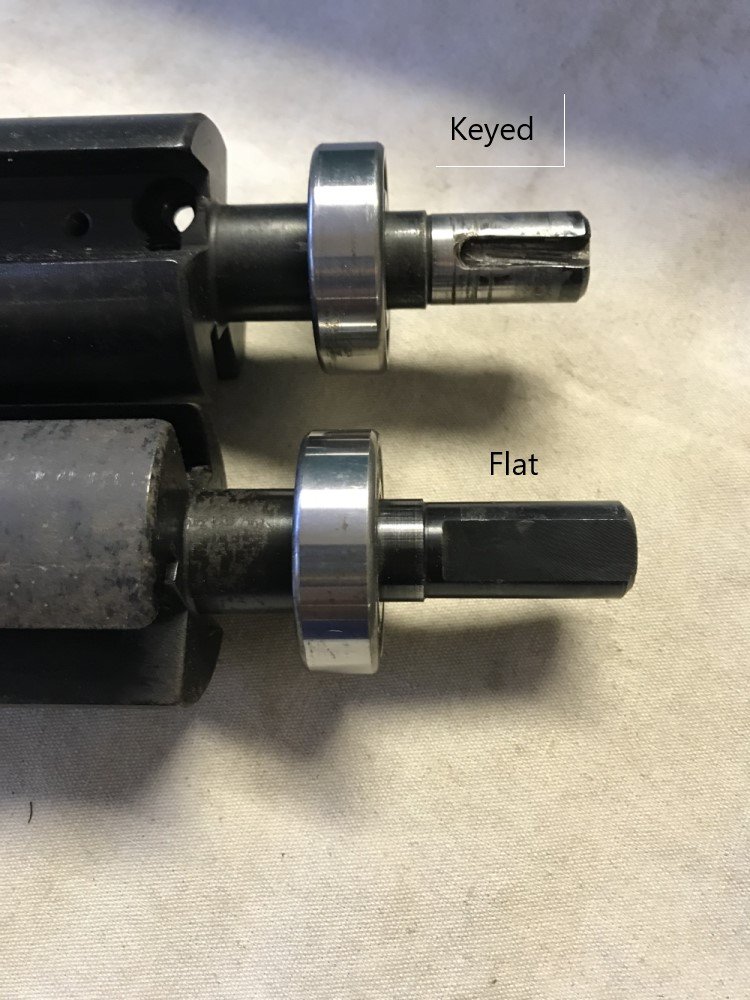

Many of the parts are the same for the Mark Mount Planer and the Stand Mounted Pro Planer. The End Frame (right and left) panels are the same for both the Mark Mount and Pro Planers. The Cutter Head is driven differently for the Mark Mount Planer using a Power Coupler Hub and opposed to the Pulley and Belt Drive of the Pro Planer. Early Planers had different ends for the Mark Mount and Pro Planers on the Cutterhead Shaft. Mark Mount Planers have a flat spot on the end of the Cutterhead Shaft for the Hub to attach to. Pro Planers have a Key slot for the Pulley on the end of the Cutter Shaft. Later Cutterheads have both the flat and key slot making it the same Cutterhead for both Planers. The picture below shows the keyed and flat shaft ends.
_
Planer Cutter Head end labeled.jpg (132.44 KiB) Viewed 6688 times

cooch366 wrote: Thu Apr 09, 2026 3:26 pm I also am looking for a set of the Way Tube clamps you pictured, Shopsmith only had 1 available and I need 2. So I’ve got my eye out for them.
If the planer is mounted at the very end of the way tubes, one clamp may be enough to hold the planer "down", as it is not going to be able to slide.
When I got my planer, it came without clamps, so I made two using some dense SYP and a knob from the hardware store. I had a clamp from a speed reducer to use as a template.

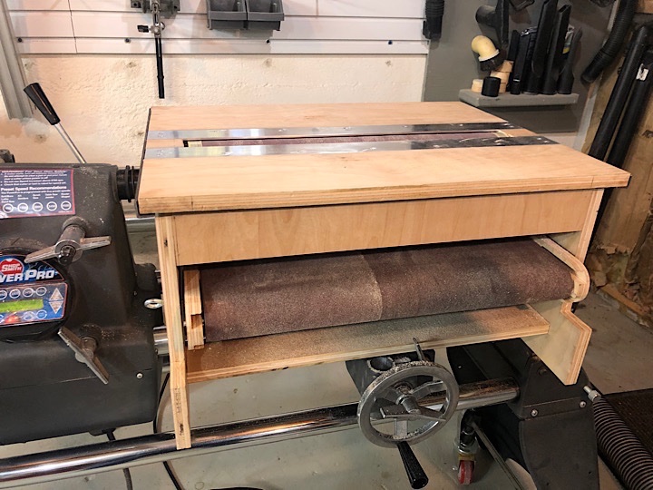

I have done something like that a while back and just used the bed sander option to make my first segmented bowls, and it worked just fine. In my tinkering I’m thinking of a Version 2, keeping the bed sander & sand flea concept but using an arbor/drum & top from Stockroom Supply. I would also like to modify the conveyor system/height adjustment (haven’t thought of how to redesign it yet). And dust collection needs to be improved. I think these modifications would definitely improve it, but I’m really pleased at how it works for a first attempt.
Agreed that dust collection is an issue on a Mark mounted modified planner, but am thinking that the vacuum attachment on the planer would help.
I have also considered “drum height” as you mentioned, and agree that some “modification” would be needed. I like the idea of a modified planner which would help with the conveyor/height & some of the dust issued, but it could mean the loss of the “sand flea” option. Have to do some more thinking on it.
