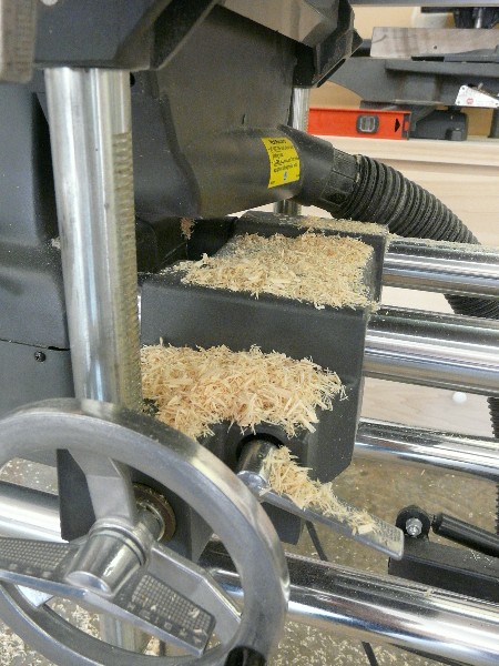

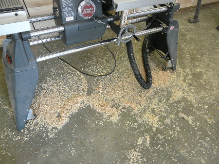

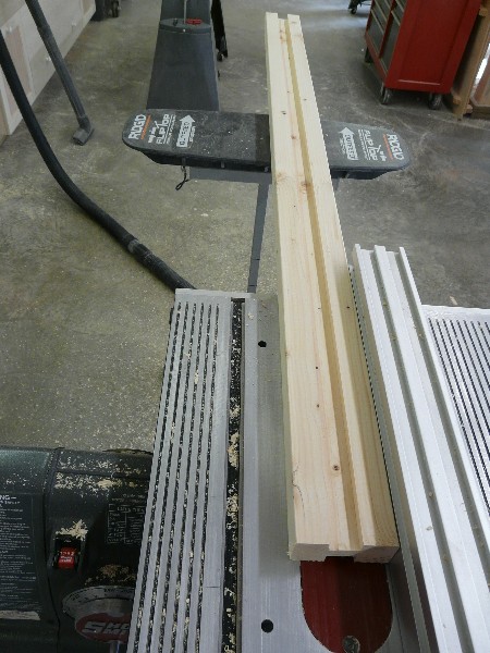

I am cutting 1/2 inch deep 3/4 inch dados in some 2/4's. I read the complaints on the poor dust collection of the Shopsmith and have to agree it could be better!;)

From the picture I would suspect your dust collector wasn't providing enough draw. I have had similar dust patterns when I forgot to turn on the dust collector.
If you dust collector is up to the job and was running then something that seems odd to me is the dust directly under the lower dust shield, how did it get there? I often end up with a real fine dust there that I assume is blown there by the air flow but your seems to have fairly heavy pieces laying on top of your carriage right under the dust shield. That suggests to me, 1. Either the dust shield is too widely spread that there is a gap or 2. The dust shield was closed in on the blade so tight the dust could get between it and the shield that mounts on the tie bar. I tried to see in the picture if I could see the tie bar shield and I can't tell if it is even there let alone whether the lower blade shield is adjusted over to it.
Lastly you are removing a lot of wood on this operation. I believe you have a Unisaw, so for a test can you duplicate the same process and see how much dust comes out of the Unisaw?
