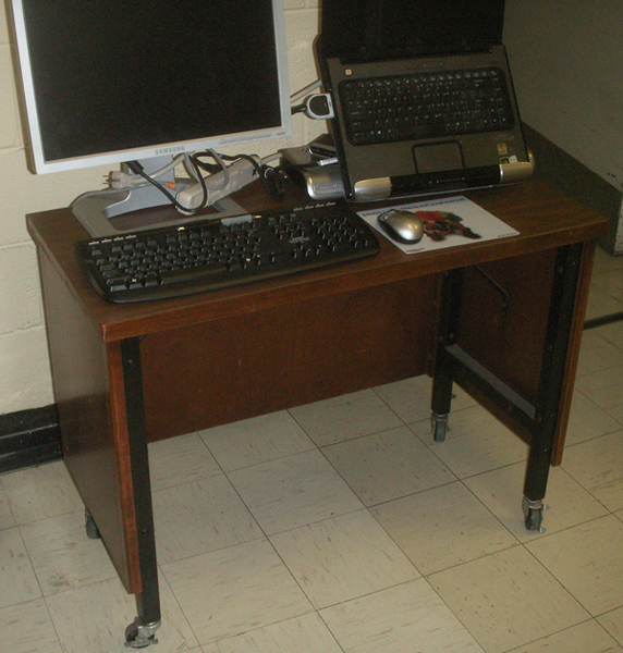

I have a small, rolling computer table that I picked up cheap as part of an auction lot. it is roughly that size. the design could be converted to folding in a couple of different ways depending on how they wanted to store it. I'll see if I can get a usable picture of it tomorrow.cincinnati wrote:I have someone that wants me to build them a small folding computer table for a large RV. The top would be around 36"x18"

it does not have a shelf, though, and I do not know how one could add a useful shelf without destroying the ergonomics.

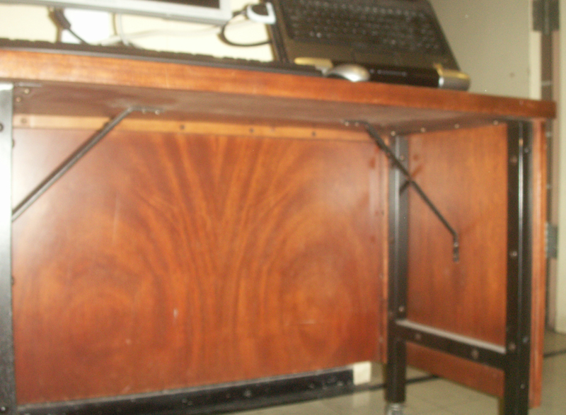

I couldn't dig out the roll-around chassis box today, but it sounds like that one is not appropriate anyway.
the pictures I took of the table did not turn out very well.
as it stands, the table is 36"wx18"dx26.5"h including the casters. it is a good height for a keyboard since the chairs that I am using with it are a little short. I suspect that the table was originally used for an old-fashioned illustrator's typewriter in an executive suite (if it is as old as I think it is, you had to be a division chief or higher to be allowed wooden furniture back then). the welded metal end pieces and metal cross-braces are overkill for laptop use.
if the customer likes the top and 3 sides of a box concept, you could hinge the back directly to the underside of the top, put a vertical piece for one side piece long enough to clear the folded-up back and then attach the side piece with a hinge, and repeat that for the other side piece but make the attached part tall enough to clear both the folded-up back and other side piece. put cleats on the side pieces for the back to lock in to when it folds down (rare earth magnets are rather neat for that) and cleats for the shelf to hook into. if they don't want the back, you could use some folding table type braces (on the corners away for the knees) or you could put a backing board on the shelf (horizontal shelf with a vertical board at the back so things don't fall off) and use the vertical to provide extra bracing.
it seems to me that making the shelf part removable rather than folding really simplifies the design issues. it may also make it more compact to store when driving. if you go with the vertical backing board on the shelf, you can also hinge that joint so the shelf folds flat.
