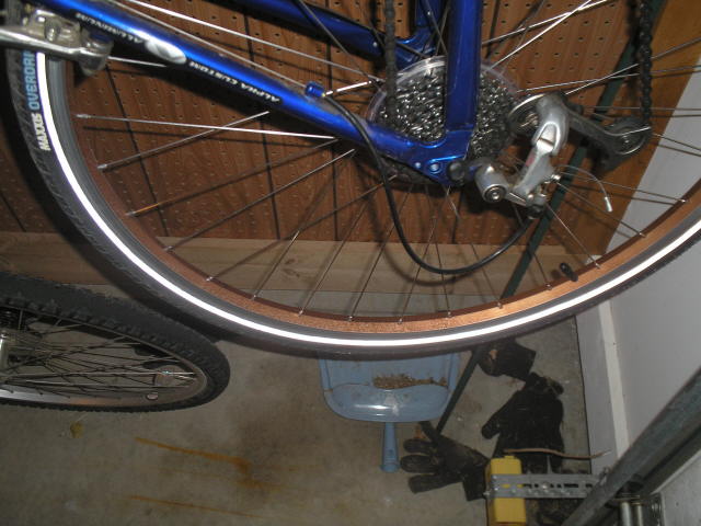

Hi,
Thought you might enjoy seeing this. Two years ago I had leftover Hammered Copper paint (Rust-O-Leum, I think) after doing some Shopsmith refurbishing. I was bored in the winter and decided to overhaul my bicycle completely. So I had the spokes all removed while I worked over the hubs. I decided a bit of copper-tone on the wheels would be sharp. I did it, and they have been fine ever since, through quite a few miles!
[ATTACH]6153[/ATTACH]
Hammered Paint on Wheels.jpg (55.92 KiB) Viewed 9846 times

Chris,
Do you recall how you prepped your wheels prior to paint? I agree that it sure seems to have held up nicely, especially on a surface that flexes.

On those wheels the preparation was minimal. Probably I just sanded them to 220 or 320 grit. I masked off the braking surfaces and painted the inner rims. I did not use primer with the Hammered paint. The only spot where the paint has come off is a tiny point on one wheel where I hang the whole bike on a hook on the garage-wall. Since that spot wore off, I hang the bike the same way each time so there are no other worn spots.
