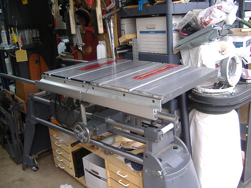

A couple of quick comments. This was not setup to do anything other then take a picture. The tubes will need to be supported with either the extension table or legs and it should work on either side of the machine.
I'll let the picture speak for itself, and if anyone wants to comment or ask questions feel free.

A viable procedure for those lucky enough to have two 510/520 main tables AND 5' tubes! I like it!!!!reible wrote:This one is for you Dusty.
[ATTACH]6245[/ATTACH]
Only improvement I would suggest is to get another main table and put one on BOTH sides of the 'normal' one.

Yup, I've got one of those too. What is more, I have bent tubes to prove that you need extension table support.
I have used this set up when I had a lot of panel work to do. I added to it something that I know you have also; the extension table brackets which help to add the needed support on the outfeed side.

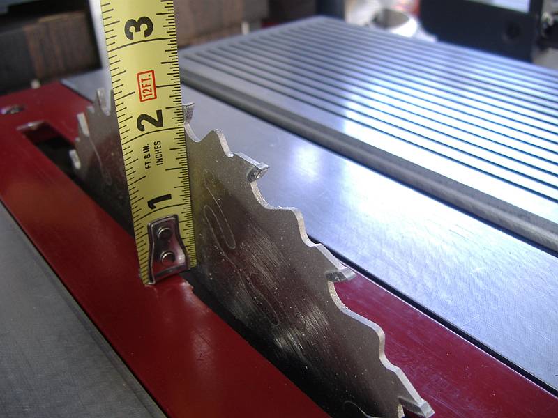

When mounted to the left the depth of cut is reduced due to the way the casting is made. It certainty looks like it would be an easy job to grind away a bit of material to allow it to go as low as the main table but I'll not do that right away as once it is gone it is gone. I don't see any issues with doing this to the table as long as I don't want to return it to use as a main table.
[ATTACH]6291[/ATTACH]

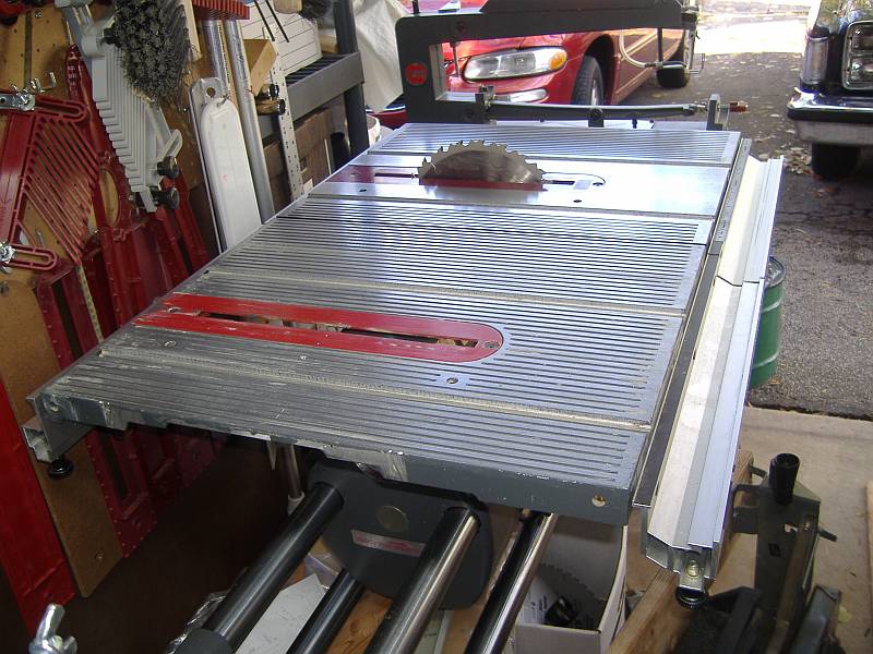

The new width of the table is just a bit wider then expected do to the bosses on 520 table.
[ATTACH]6292[/ATTACH]

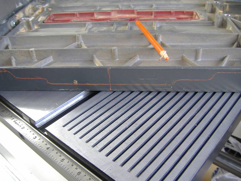

While I had it together I sketched the left side of the main table on to the right side of the extra table so you can see what is potentially in the way. This seems to be way more then is needed by just the head stock so perhaps a lesser amount can be removed. I should also mention that several of the ribs also need to be shortened.
[ATTACH]6293[/ATTACH]

Grinding away the interferring materials on that main table will not be a problem. It grinds, files and drills quite easily. I filed the sides on three of my floating/extension tables so that I could attach miter tarcks. Without filing I could not get the tracks parallel to the main table miter tracks.
The only concern that I might have is removing that much material. What adverse effect might that have on the structural integrity of the table? Will it remain flat?

You CANNOT adjust depth of cut however without someone to help or without dismantling the extra table. The weigh torques the carriage so bad that it disables the lift.
