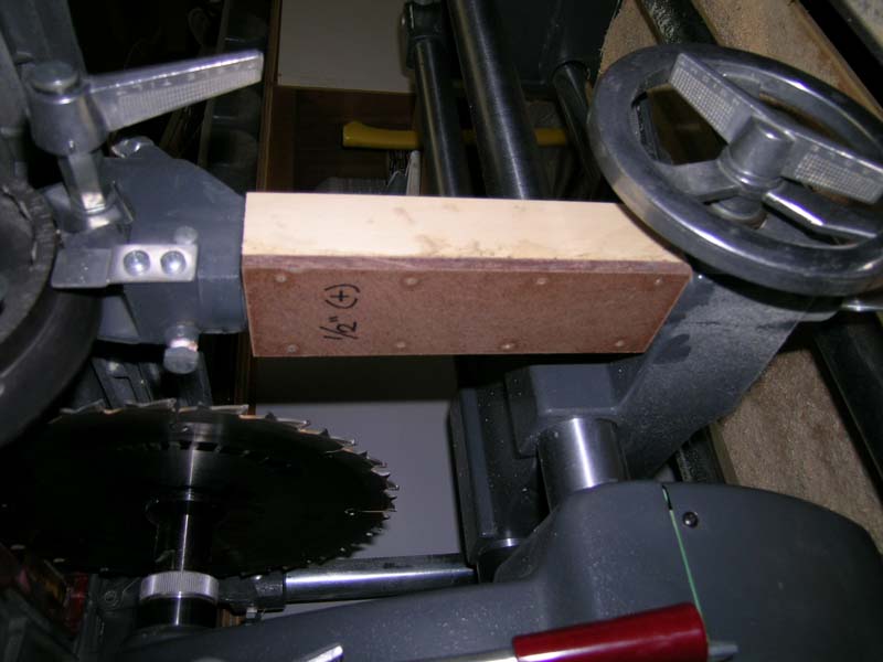

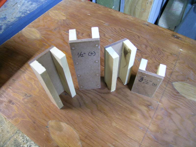

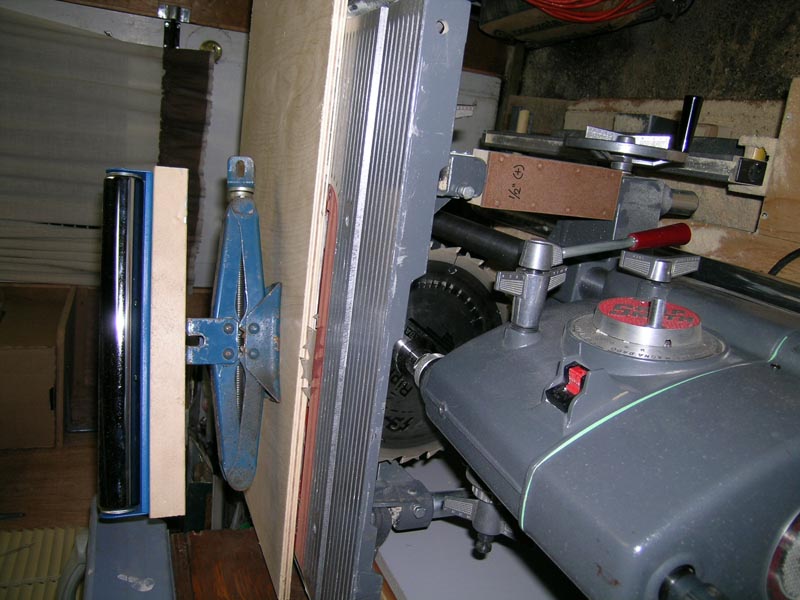

Here are some photos of the jigs I made to quickly set the table height for a particular blade. (you need to make different jigs for different blades if they are not all the exact same diameter. The same with dado blades).
In one you can see the jigs for 1/2", 1", 2" 1nd 3 1/2" protrusion of the blade.
One shows you how the jig is set under the table, and the third photo shows the jig and a 1/2" plywood on the table top so you can see how it works.
I used my adjustable support roller to hold the plywood down against the blade. It is an old car jack with a roller attached to the top. I can regulate the roller height micrometrically (Ha, Ha) and of course can load half a ton. Very handy when I want to change the table height and quickly adjust the roller height for the task.

Thanks! I wonder how many times in the last 50 years I've set the SS table for a 1/4" cut? I'll certain make two, one from 1/4" cut with the standard (10") blade and one for a 1/4" cut with my 1/4" dado blade (8").
jcbrowne wrote:"Here are some photos of the jigs I made to quickly set the table height for a particular blade. (you need to make different jigs for different blades if they are not all the exact same diameter. The same with dado blades). ..".
This is actually brilliant, J.C.!! At first I didn't see the value, as I had become so accustomed using the adjustable collar. The collar is still very useful for fine adjustments when drilling, routing, and setting fine adjustments other than "spacers".
BUT!! for quick setups for normal operations, your invention is invaluable! I put it in the same category as the adjustable stop collar! THANKS FOR SHARING!

It appears to me that the 3 1/2" block is smaller than the 1/2" one? :eek:
