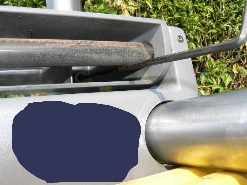

bvrsbro wrote:Thanks.
I've started that process I noticed when I tightened work between centers that the tubes move out about 1/16". Is there any way to tighten the tubes in the ends that the tail stock is? There are set screws on the other end.
What tubes are moving 1/16"??? If it is the Way tubes, they do have set screws, but they are neither easy to see or tighten.
[ATTACH]6549[/ATTACH]
Ignore the blue 'blob'. Bench tube lower right, way tube upper left(raised to vertical drill press position).
BASE REASM HINGE PROBLEM copy.jpg (61.39 KiB) Viewed 8576 times
