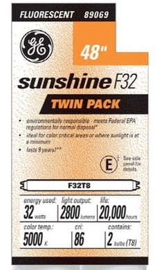

I just replaced the fixture in my laundry room / shop with an 8 foot fixture that uses four 4' T8 bulbs.
The term daylight bulb doesn't mean too much and some of these bulbs bear little resemblance to daylight, at least on this planet. The bulbs I bought were:
[ATTACH]6558[/ATTACH]
The most important numbers to consider are the color temperature and the color rendering index (CRI). Sunlight has a color temperature of about 5000 to 6000 K. The CRI index gives a measure of the effect on the appearance of colors when comparing a light source to a reference source of the same color temperature. A CRI of 100 is perfect.
You have to consider both values, for example a High CRI value combined with a color temperature that is significantly different than the sunlight value of 5000 to 6000K can not really be considered a good "daylight" bulb.
Similarly, a low CRI index on a bulb in the correct temperature range may be disappointing as well.
On the whole I hate fluorescent lights but these bulbs are a huge improvement over the 8' T12 cool white bulbs I had before.
The new electronic ballasts reduce the flicker to about zero. My only gripe is that the light fixture creates so much interference that the radio is pretty much useless.

Dave - Research the color temperature a little before you buy your next bulbs tomorrow. If wikipedia is accurate (see the table in the Spectrum of Light section halfway down the page), the HD bulb specs you showed have a color temp of 6500 F (3866 Kelvin) which appears low compare to the table. The GE bulb Troy shows in his post is a 5000 K which is wht is considered the min value for daylight.judaspre1982 wrote:This is what I bought http://www.homedepot.com/h_d1/N-5yc1vZ1xgy/R-100476640/h_d2/ProductDisplay?langId=-1&storeId=10051&catalogId=10053. Not listed in the the specs are---Light Output=2800 lumens----Color Rendering=85. I just came in from the shop. I worked in the new lighting section until dark and love the Daylight bulbs. I will be changing the Cool White tubes out in the other section of the shop tomorrow.----Dave
Don't go by my post here since I don't know for sure but just research it a bit. What it all comes down to though is if you like what you already have, that's all that matters.
