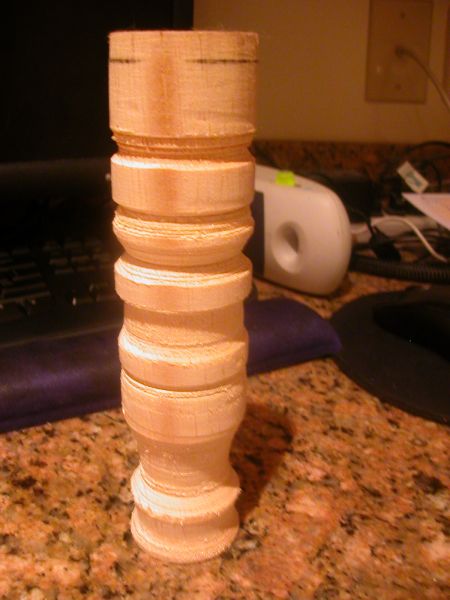

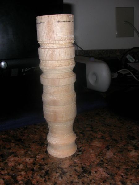

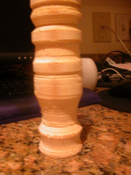

My son I and were experimenting with the lathe tonight. We got it kind of round. Then we tried doing some coves and valleys. I used the 60 degree live center and the drive center that came with the SS.
[ATTACH]6819[/ATTACH]
[ATTACH]6820[/ATTACH]
[ATTACH]6821[/ATTACH]

What lathe tool did ya use?

What ever tool you used it needs sharpening. I don't mean to sound harsh and by no means am I trying to dishearten you about this, but you really need to learn how to sharpen the turning tools before you learn how to turn. Many beginners get disgusted and quit trying simply because they don't realize that a sharp tool is a requirement and not an option when turning. Not to mention that a sharp turning tool is safer to use because it is cutting the wood instead of tearing at it. Please take this as constructive criticism and not as dissing your attempts in any way. I hope you continue learning and am sure you will come to love turning.

I used the 1/2", 1" gouge and skew.
re: curiuosgeorge>Thanks also for the recommentation to sharpen them. Glad I found out now before I started doing something really expensive. No hard feelings. That's why I come here to learn from the "experts". I have to crawl before I can walk, then walk before I can run....

I'd say STAY AWAY from the skew for now. It's a great tool, but knot easy to use without some help.
