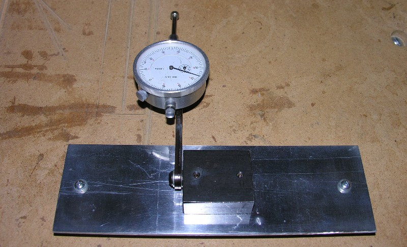

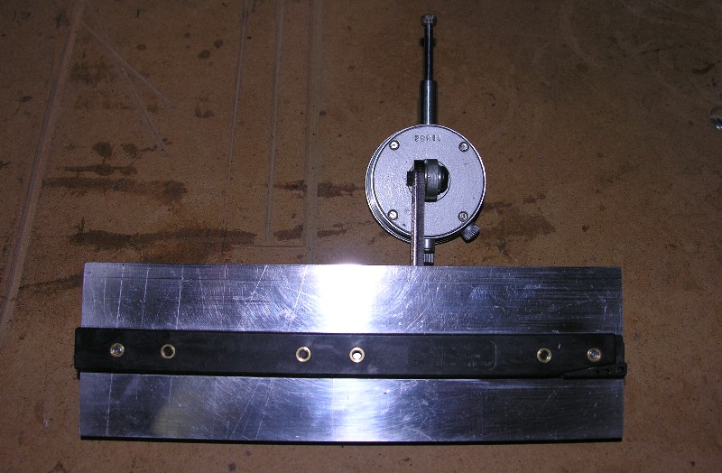

These look like they would be very useful for the building of jigs. It seems that they would be especially useful in jigs used to complete alignments and set ups. The miter slot and standard miter bars allow about .003" variability. These will eliminate that completely.
The Zeroplay Guide Bar & Stop System appears to be a handy addition to the alignment tools for the SS and table saw. I put together a simple guide jig for the dial indicator from SS. It allows you to adjust about all of the slop out of the guide bar and makes it easier to get an accurate reading for the arbor and fence alignment.

[ATTACH]7108[/ATTACH]
[ATTACH]7109[/ATTACH]
- DialIndicator1.JPG (127.25 KiB) Viewed 5258 times
- DialIndicator2.JPG (113.13 KiB) Viewed 5243 times
