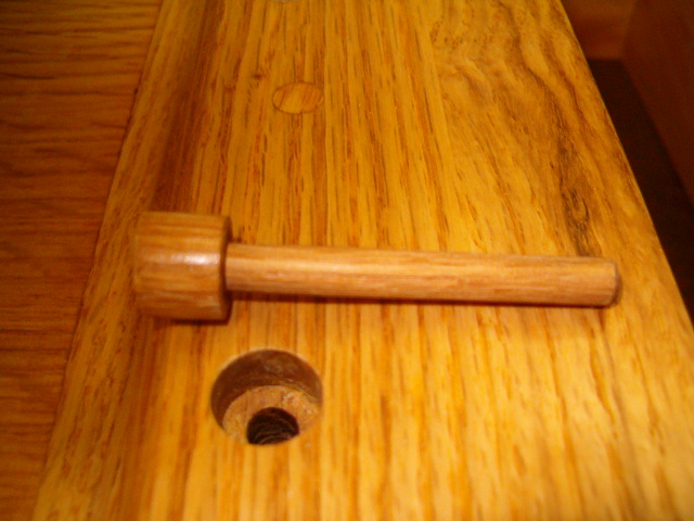

How about going back to the wood dowel thought. You could make something like the pictured peg on the lathe. You could size the peg on the lathe to fit a dowel hole and the head diameter to your taste. Then it would be easy to square up the big end (head) with a sander. Also a sander could be used to sand the bevels on Greene & Greene plug heads.
[ATTACH]6911[/ATTACH]

Charlese, that's a great idea for making the square plugs. I'll have to keep that in mind. But I have never ever turned before, my lathe chisels aren't sharp, and... I just don't think I'll have be "lathe ready" in time to do that for this project. And I still don't have any pads for the disc sander (I forwarded the recent sale email to "Santa"), so all I have is a 5" random orbit and a 1/2 sheet sander.

Try this 3 step process: 1. use a plug cutter or holesaw to cut the big round plug out of scrap wood (it could be any diameter you choose, just make it match the holes in the frame). 2. Drill a hole in the plug (you could even drill this hole before cutting the plug). 3. Insert a dowel into the drilled hole in step 2.charlese wrote:How about going back to the wood dowel thought. You could make something like the pictured peg on the lathe. You could size the peg on the lathe to fit a dowel hole and the head diameter to your taste. Then it would be easy to square up the big end (head) with a sander. Also a sander could be used to sand the bevels on Greene & Greene plug heads.

There are examples of the Greene brothers using round instead of square plugs (page 10 of that PDF document includes one). The thing I didn't like about using a dowel is that the surface of the plug is end grain instead of face grain. And I don't have a plug cutter. Leaving an aluminum or brass rod and leaving it proud is definitely worth considering. But bluekayak brings up a good question about how the metal would age. Would it tarnish (relatively) quickly? What could be done to prevent that?
