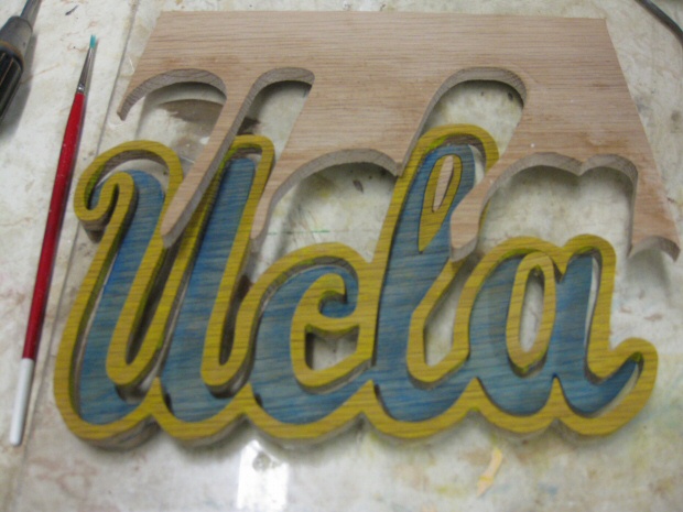

Avoid breaking woodit takes practice to make clean tight cuts. Try to make the smallest cuts first, so that a large wood mass supports the work. When you make a cutout, try to catch the cutout. Then replace the cutout and tape in into place with some scotch tape. Top and bottom if possible. This will allow you to make the next cut with a support piece in place.
[ATTACH]6938[/ATTACH]
I am working on this UCLA sign for my granddaughter. (work in progress)
The center of the "L, A & C" were cut first. I stuck the center of the L back in for the photo. These were taped back in, then the blue UCLA was cut. This was again taped together, a sacrificial back was taped on, and the thin yellow UCLA was cut.
