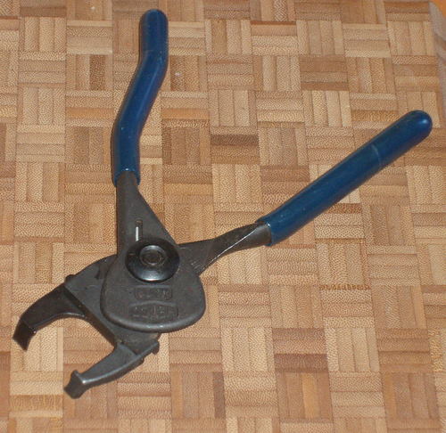

You know that there must be a tool for everything, right? Even these simple plastic grommets. With offset jaws so as not to inter fear with the cable
I found this in an electronics surplus store ....
[ATTACH]7320[/ATTACH]
- P1110049.JPG (62.03 KiB) Viewed 38126 times

Those Heyco plastic strain reliefs are no Simple Grommet!albie wrote:You know that there must be a tool for everything, right? Even these simple plastic grommets. With offset jaws so as not to inter fear with the cable
They are shaped with opposing flats and are mounted in a double d hole(prevents rotation).
They incorporate an offset pocket and 'pusher' to secure the cord(keeps it from moving in /out).
They have a groove below the outer flange which prevents it slipping out of the hole(to over come this that tool(or channel lock) is needed).
The effectiveness of the retention groove is what makes it so difficult to remove. Realize that when squeezing the 'small' part, you are compressing the power cord!
Be thankful of the current 'improved' design which connects the two pieces so as to not lose one of them while 'removed'.
