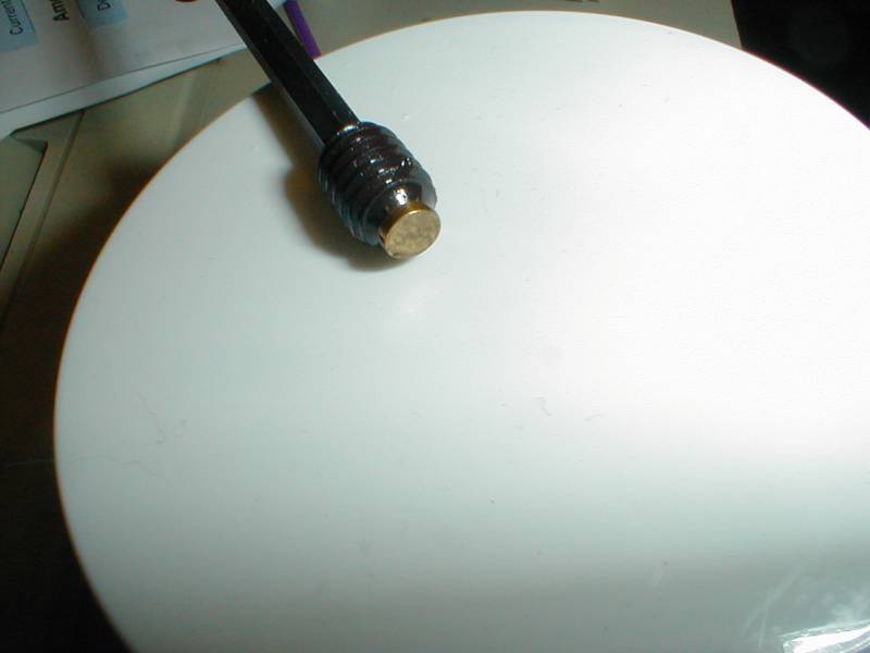

Anyway while we are on set screws I went and check a few of mine tonight. One thing is for sure they are not all alike, and I'm not talking lengths or cone point or flats. On two of my newer 520 type arbors they have a set screw which looks like it has a brass part on the bottom. I guess the class is flat but still a bit different then the rest of the dozen I looked at.
- P5300005s.jpg (25.77 KiB) Viewed 29413 times
