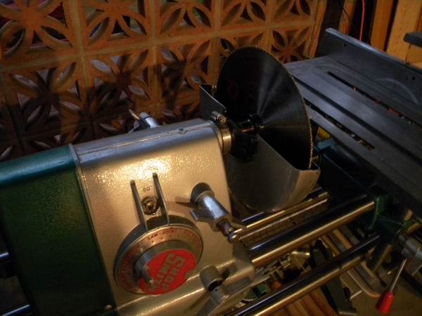

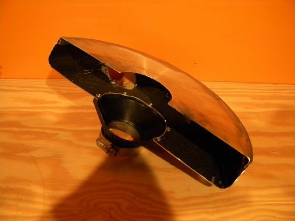

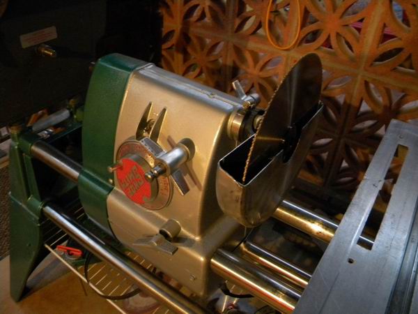

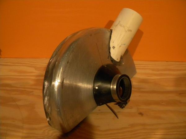

These are a few photos of my new saw guard for the greenie I have for sale. It came without any saw guards at all and I didn't want to sell it without at least a lower. Now my concience is a lot clearer.

Hammered silver photo tomorrow.

- shipwright
- Posts: 1165

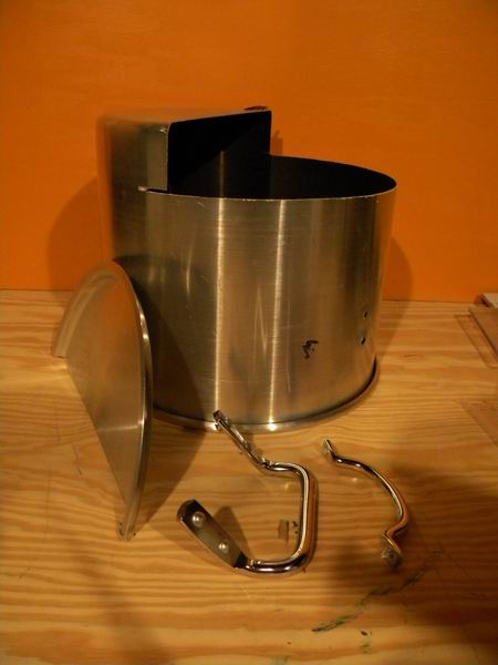

And I still have this much of the stock pot left.
[ATTACH]7475[/ATTACH]
I think there's an upper guard there too.
Accounting: Aluminium stock pot--- $2 at the thrift store
3" to 1 1/2" ABS reducer about $3
+ Insignificant shop supplies =about $5
And it keeps the under table fingers on the hand.
Paul M

What is the neck made from?
Never mind, I went back & read it!!!

Not Rubber
It's actually remarkably solid. The mount is ABS and completely rigid. I certainly understand your concern if you thought it was rubber.
Thanks for the comment
Paul M
