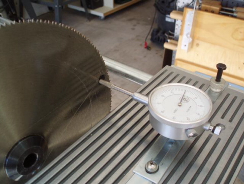

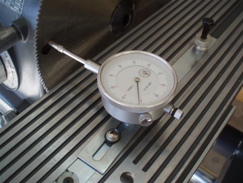

Influenced by Nick and the Sawdust Sessions, I have adopted .005" as my pass fail criteria when using the dial indicator for table, blade and fence alignments. If you want it tighter, you can get it tighter but the first time you have to reconfigure you will likely lose it again.
There are two or three built in variables that make it almost impossible to keep the tolerances tighter than about .005" without tweaking.
The miter bar is one, the table and carriage locks are two others. Every time one of this is changed, some variability is introduced.
Solutions are limited only by the breadth of your imagination. Incra sells a miter bar that is excellent. It has adjustments that allow you to take all of the sloop out of the miter bar. It happens to have a threaded hole that is idea for mounting the dial indicator.
[ATTACH]7477[/ATTACH] [ATTACH]7478[/ATTACH]
I have now changed out the Incra miter bar (I need it elsewhere) for an aluminum plate to which I have attached the dial indicator. This plate is equipped with the miter bar from the Shopsmith setup that came with the dial indicator. The weight of the fixture keeps it stable and eliminates the effect of the miter slot sloop (which is about .003").

efmaron wrote:Dusty,
I am confussed with the pictures in post #4. The pic on the right shows a indicator reading of -.001, and the pic on the left shows a indicator reading of about +.040. Is that correct or am I missing something.
I can't read the indicator on the left but if you say that is what it reads that must be right. However, if that is what it says, the alignment must have been in progress at the time. My table typically aligns to within .003" and I hardly ever have to tweak it.
The point of this particular post was to show one of the methods I have used to eliminate the sloop in the miter track.
:(I'll be more careful with the photo evidence in the future!
