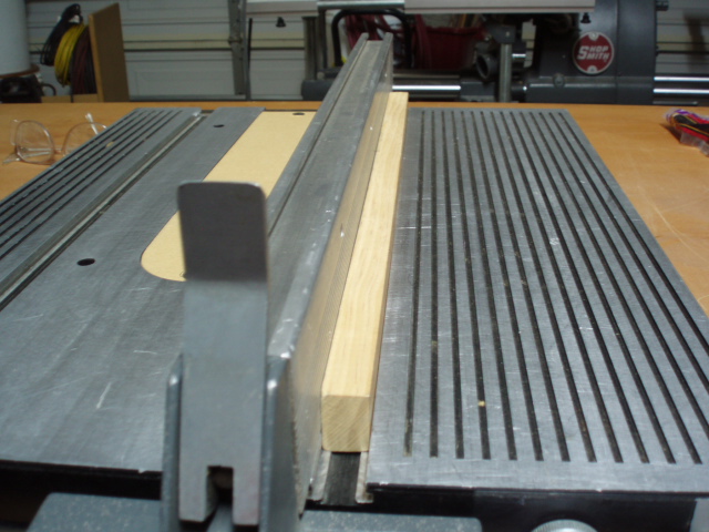

I have done exactly what 8iowa has suggested but with a slight twist. I have a piece of wook milled to fir firmly in the miter slot. With that installed, I slide the fence tight against it. This shows whether or not the fence needs alignment. If it does, loosen the screws and then slide the fence back against the piece in the miter slot and clamp it there with two spring clamps. Re-tighten the screw or screws (depending on fence being used).[ATTACH]7908[/ATTACH]
- PA130001.JPG (137.11 KiB) Viewed 13265 times
I did that, just as you and the book suggest. What happened was that The fence was square and aligned when I tightened the back screw. After removing the fence to tighten the front screw and reinstalling it was always out of alignment after putting it back on the table. I tightened the heck out of the screw and slid it off very carefully, didn't make any difference I don't think the fence is bent, it seems to be moving when I tighten the screws. The movement was always the same.
Is it possible to loosen the front screw to much? The fence is set now. I ripped a rough cut 4/4 oak board and it worked fine, but I'd like to know what is different about it this time.
