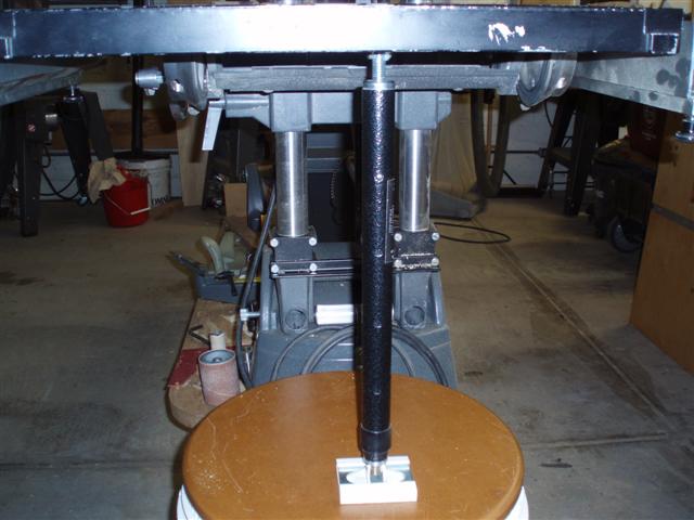

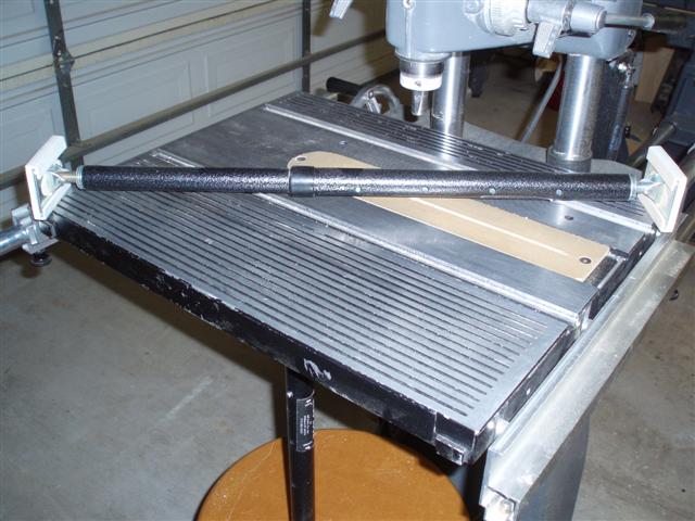

The main table, in the drill press mode, should be square to the axis of rotation of the main drive shaft in all directions.
If the table is either high or low to the left or right sides, that is corrected by adding shims on the trunnion bolts between the trunnion and the table. Once done correctly this should never change.
The table should also be square to axis of rotation front to back. The table tilt adjustments can adversely effect this alignment. If the tilt lock is not secure, the normal pressure of drilling can cause the table position to change.
The back side of the table can go down just so far and it is then stopped by a table positioning bolt (part of the alignment procedure). On the other hand, there is nothing built into the table system that will absolutely prevent the front edge of the table from sagging.
When drilling something where the entry angle is critical, I use the adjustable legs to secure the table. I don't believe you can tighten the table tilt lock tight enough to prevent the table from sagging in this manner.
[ATTACH]7927[/ATTACH]
[ATTACH]7928[/ATTACH]
These adjustable legs came out of our old fifth wheel. They were accessories used to secure the expansion room in place when we were traveling. I sure am glad we didn't leave them in the fifth wheel when we traded it.

Thanks for the replies, machine is adjusted to be square according to the set up procedures, the movement or sag about the trunion pivot is the problem. Initially I thought it was just the act of tightening the hold down that changed the tilt angle of the table. But judging from the use of additional supports here, it sounds like I'm not the only one with this problem. I look forward to seeing what Robinson has in mind to brace this. and Dusty, when your done there.....
