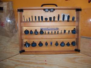

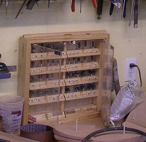

I have a set of Ryobis just like Mark's at home in Canada. They work out at about a dollar a piece if you buy them on sale. I've had them for about three years and as yet none are broken and only the 3/4 plywood dadoing bit (23/32 as I remember) is even dull. I don't know anywhere that sharpens them for $1 so if the rest ever get dull, I'll buy another set. The variety you get with a set like this is amazing and they'll last a long time for all they get used. When you find bits that you actually do use a lot or when you need special purpose bits, buy them but a set like this is the starting point for sure.

I have a similar set (Mastercraft) in Az and the same goes-- lost leaders on sale -- about a buck a piece. They are indistinguishable from the Freuds I also have at home except that they were cheaper and not as pretty. I but "high end" bits only when I can't find the pattern I want in "cheap" ones and have seldom been disappointed. There is a lot of "boutique marketing" and "big name" merchandising going on out there and for the most part IMHO the emperor would be better off with a few more clothes on.
