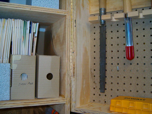

P.S. Don't throw away your dado blade(s) The are sometimes very useful and give good results on shorter cuts and longer grooves and rabits. Here's an example of dados and a joint made with a wobble dado. Flat bottoms and no tear out on pine plywood.
