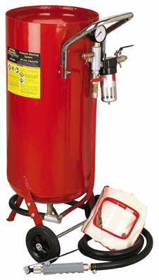

I have been thinking of getting a blast cabinet, but have never even seen one. Do any of you guys know what else I would need to start blasting? I have a compressor.

You need a pretty powerful compressor to run these with any good performance. I have a Craftsman compressor but it only gives me 8-9 cfm at 125 psi and that isn't anywhere near enough cfm to run a blast cabinet. I was looking into them as well recently and most of them require somewhere around 15 cfm minimum at 90 psi. There are some guns that have very small orifices that will run on lower cfm output but you will be there all day blasting with those I am guessing. If you find something worth while please share with the rest of us. I still would like to get one as I could use it all the time for various repair work but I can't afford to buy another compressor to run the darn thing.

Mark, I have 2 cabinets. What are your intentions with a sandblaster? The HF Cabinet is a syphon blaster but it can be converted rather easily to a pressure blaster. The H F cabinets have a real tendency to leak as they are delivered, if you get one I would recommend using a tube of silicon caulking on the joints before using. Depending upon what you want to do with a blaster, you may want a pistol grip valve, a deadman valve or a Richman foot peddle valve. Another couple of options you might want to consider is a light in the cabinet and a port to hook up a dust collector. If you don't have a good dust collector hooked to the cabinet, by all means use a respirator. Silicosis is a nasty side effect of breathing the dust from blasting.
Media is another variable based upon what you want to use it for. Common medias are Silicon Carbide and Aluminum Oxide. Common grit grades range from 50 to 250. Other options are out there (ie. Black Beauty or slag) but don't waste your money on those, one run through and their wasted.
Let me know more about what you are wanting to do with one and I can get more specific.

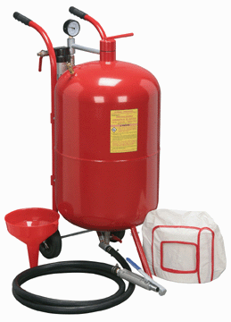

I do not think 'playground sand' makes good blasting abrasive!mark-b wrote:Hey Tom!
As I look into blasting, what are your thoughts on a simple pistol blaster (siphon)? In addition to cleaning up some Shopsmiths, I am thinking that it might come in handy for cleaning lawn furniture, wrought iron, and such.
Thanks, Mark
Can I just siphon out of a bag of playground sand??

I was talking with my neigbor about sandblasting, and he has a siphon blaster that he uses on his little compressor with playground sand. So I found a compressor on Craigslist, borrowed his nozzle for 5 minutes and it works great!
