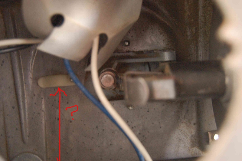

5. also there is a little plastic tab inside the headstock - is this a wire restrainer?

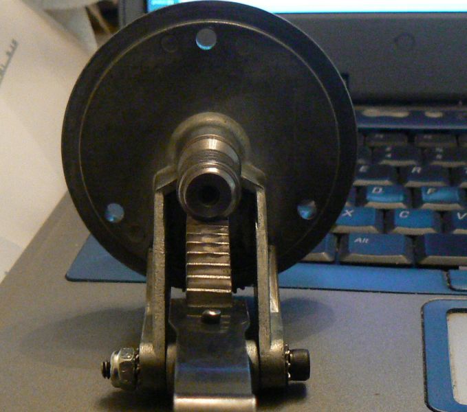

The bracket that holds the pin that the porkchop rotates on is prone to getting bent(Probably caused by too rapid a change from high to low speed by forcing the dial). This causes the worm gear to become misaligned with the porkchop gear.
Bill Mayo came up with an excellent 'fix' The pin is replaced with a #10 cap screw and the legs are carefully formed back to their original position which places the worm gear over the center of the pork chop teeth. A lock nut secures the threaded end of the screw.
The soft aluminum teeth on the porkchop may need to be cleaned up with a file if they have become 'mashed'.
[ATTACH]8822[/ATTACH]

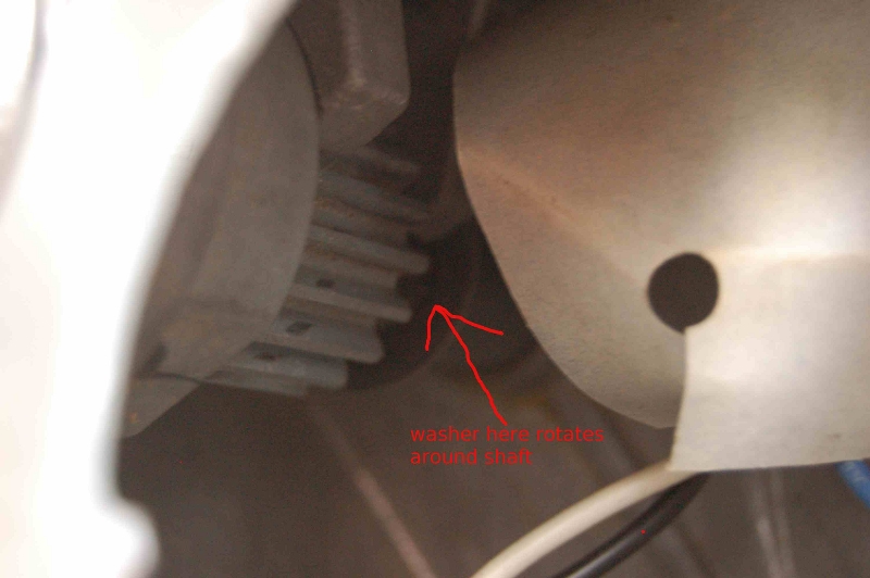

The washer that is 'rotating' with the quill feed merely sets loosely on the quill feed shaft when it is not 'locked'. Rotation normal!

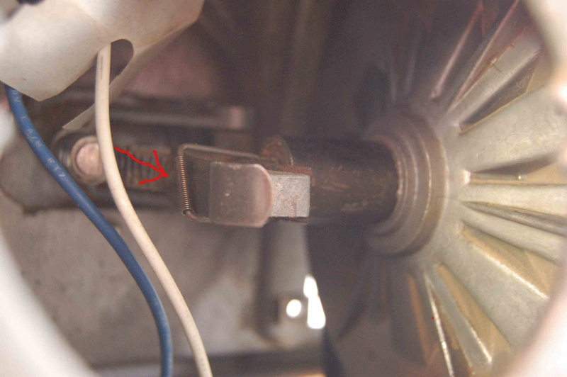

The clip between the control sheave and the porkchop is free to flop around when the speed is not being adjusted. Pix is normal!

Hi
I(t appears to me from your photos that the washer you are referring to is on the quill pinion feed shaft. That would be the shaft that moves when you move the quill in and out.
That washer is supposed to be there and will rotate around the shaft. It appears to be the domed washer that clamps the quill housing when you lock the quill.

I highly recommend that you utilize that plastic clip. It is there to keep the wires from getting engaged with the mechanics inside the headstock. Take it from one who knows first hand, failure to control the location of thosde wires leads to "sparks and smoke". Not "fire and smoke" but pretty significant fireworks.tunznath wrote:Hi All
