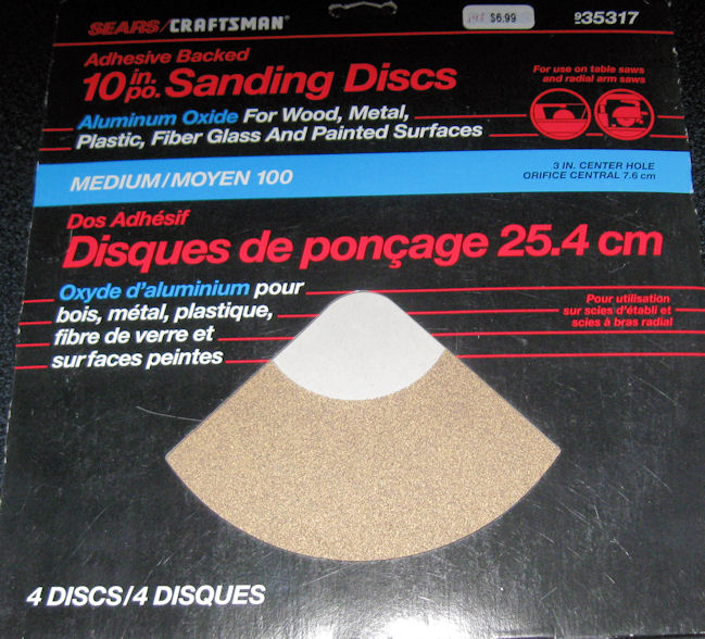

I have some packages of 10" diameter peel and stick sandpaper that I bought on sale years ago and wanted to use them with the SS.
[ATTACH]9529[/ATTACH]

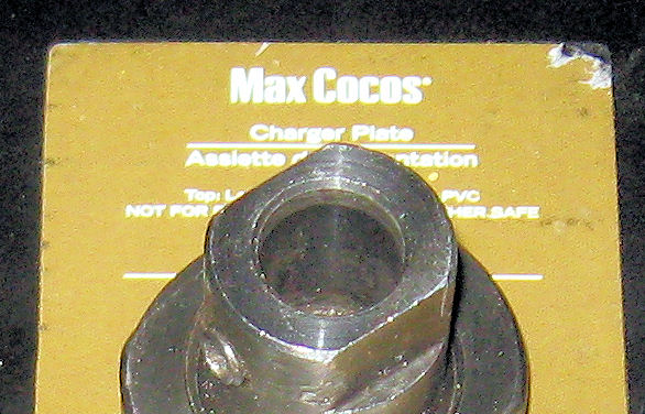

I was wandering through a home accessory store following LOML, and noticed a display of charger plates on sale.
[ATTACH]9530[/ATTACH]

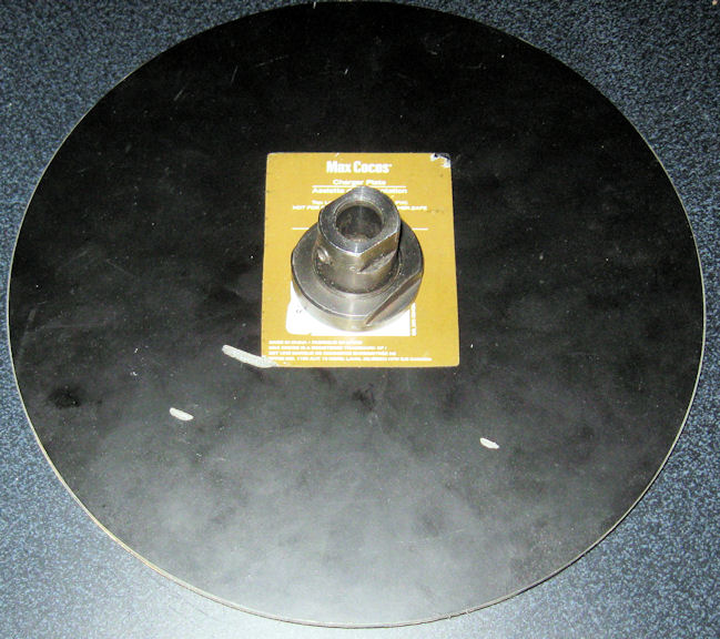

As bought, for $4.00, it was a flat disk about 12" diameter and a little under .25" thick, made of wood laminate and pvc.
[ATTACH]9531[/ATTACH]

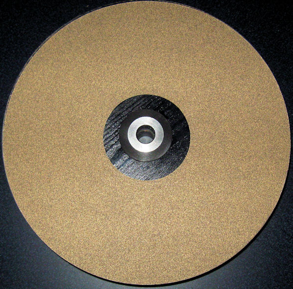

I thought it looked a lot like a sanding disk and after drilling a 1.25" center hole for a spare saw arbor and cutting it down to 10" dia., it still does. [ATTACH]9532[/ATTACH]
It was quite abrasive to turn to size on the SS but having the strip sander set up to repeatedly sharpen the chisel was very handy. It seems to be adequately stiff while turning, and flutter free. I intend to run it on the slow setting.

I rank the SS 12" ones at the top, a steel 10" next and a charger based one a long way down at the bottom, but it does fit my arbor (used a hole saw to "drill" it) and lets me use those Sears sanding disks right now. Time will tell how long it will last. I will try not to lean.
