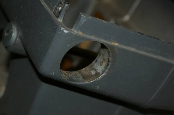

Recently I posted some pix of my headstock rebuild and the rotted wire insulation. That same rebuild also revealed another potential problem that may cause the headstock to drag on the way tubes when it is being moved.
[ATTACH]9678[/ATTACH]
The black "stuff"is old wax buildup and some embedded sawdust that accumulated over a number of years. Most was removed with some solvent and the really stubborn stuff with a three cornered scraper. (gently)
This stuff was also found in the quill bore in the headstock and was removed by wrapping piece of 3M green scrubby pad attached to a stick and some solvent. After cleaning, the bores of the holes were polished and waxed. The headstock will now move on the way tubes with one finger pressure.
Bill V

wa2crk wrote:Recently I posted some pix of my headstock rebuild and the rotted wire insulation. That same rebuild also revealed another potential problem that may cause the headstock to drag on the way tubes when it is being moved.
Bill V

Yes the carriage also had the buildup. Too much wax and not enough buffing I suppose
Bill V

Thanks. I needed this because after cleaning up the tubes and waxing, this garbage kept showing up. Loosening the headstock lock always causes a popping sound. Tomorrow, it will be solved. :)

Swampgator, The popping sound is more than likely to be caused by the wedge locks that hold the headstock to the way tubes have become rounded and they have to have a flat surface. Check Nick's sawdust sessions for instructions on how to fix that problem.

Doh.. Mine does that.. When I loosen the headstock lock I hear a loud 'Pop!'.. I'll have to look into the fix.. Thx!
Of course my headstock does not slide with 1 finger pressure.. :(

Anybody know a way to 'fix' that without removing them?
