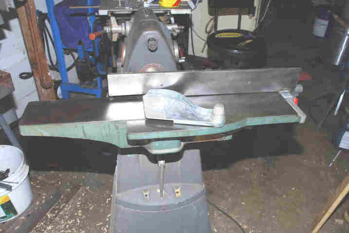

I picked up an old "Green Magna jointer" from the bay.

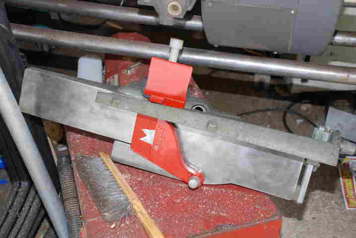

I've disassembled, cleaned the head and checked the bearings.
I sharpened the blades. cleaned up the table, fence and guard.
I picked up a back guard assy from a newer jointer. Had to drill and tap the base, and fence for the two guards.
I painted the guards with rustoleum federal safety red.
I've checked that both tables are coplanar. It cuts great, except that with the straight mounting tubes, I have about a 1/4" offset on the drive tube. With advice from several here, I've ordered a pair of offset tubes.
When my tubes get here, I going to disassemble it again, and paint the body, and fence.
I have a quandary? all the rest of my tools are shopsmith gray.
But I kinda like the original Magna green.
What would you-all do???
If gray what color gray would be a good match.
Somewhere, I saw the Magna hammer-tone green paint#, but I can't find it again. What number is the magna green?

cleaned up, and tested
Guards, installed and painted.

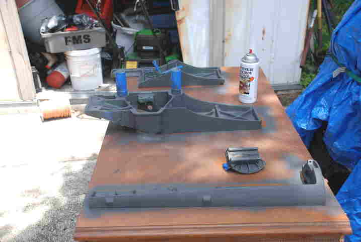

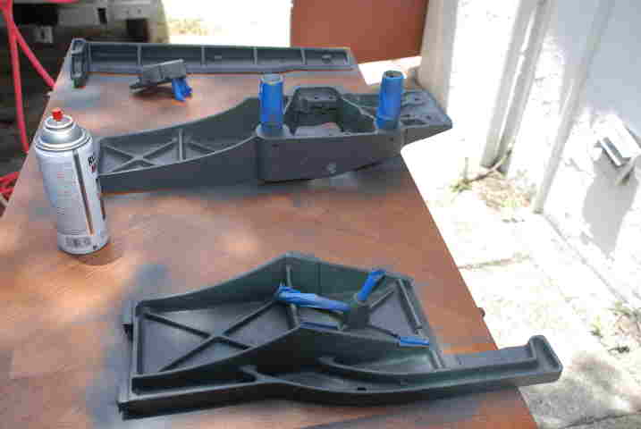

Well I completely stripped down and prepped the jointer.
I was going to paint it with Rustoleum hammer tone "Verde green".
But after a thorough local search, there was none to be found. I just painted it with Rustoleum textured gray. The finish somewhat matches the band saw (sorta).
Tomorrow after the paint is dry and hard, I'm going to put everything back together.
What is the best lubricant(s) for the infeed table contact points, and the depth adjustment screw assy?[ATTACH]9882[/ATTACH]
[ATTACH]9883[/ATTACH]
