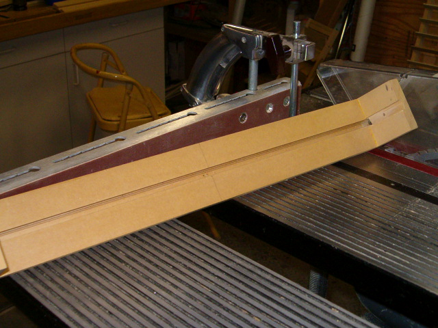

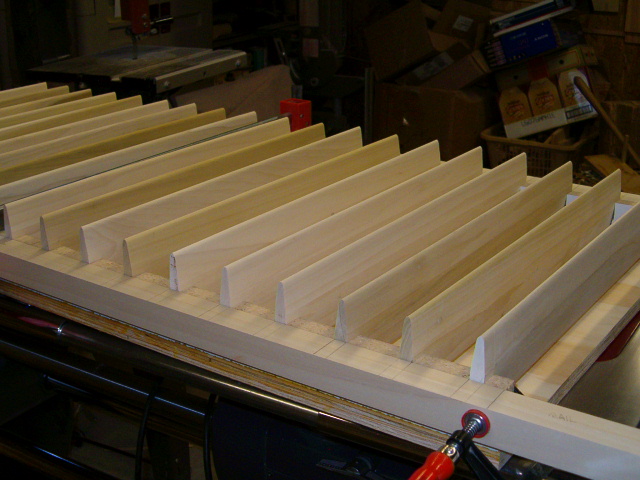

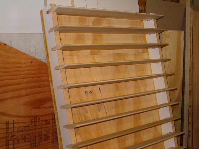

Last week was taken up with searching out enough shop scraps to build a jig (21" by 57") to hold 19 louvers and also align the shutter frame. (photo below). Also required two shop sessions to make a simple little jig that will hold the louvers for boring holes for staples and end pin holes. Three pieces of wood, but had to be exact. Found there is a very small difference between too tight and too lose. (Picture below)
I now have a new appreciation for precision to .01" and smaller. When I made my indexing fence (in order to saw slots for the louvers) I thought it was right on! From all the measurements I could make there would be exactly 2 1/2" between the 1/2" slots. Turns out I must have been about .008" off. (That is just a wiggle of the bolts securing the jig to the miter gauge) By the time I sawed out the 1/2" part of the slots (19 of them) I ended up almost 3/16" longer than planned at the other end. (57" down the line). Since .01" times 19 gives .19" - figured I must have been just short of .01" off. Next time I have to do something like this I'll start in the middle and work toward both ends. As these grooves get deeper, they also get smaller, in steps, to accommodate the taper in the louvers. This was an easy thing to accomplish with my wobble dado.
Marking our stile pin holes.jpg (134.51 KiB) Viewed 3530 times
Louver-Frame jig.jpg (121.32 KiB) Viewed 3529 times
Louver jig for staple & pin holes.jpg (129.68 KiB) Viewed 3526 times
